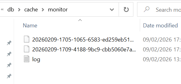

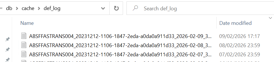

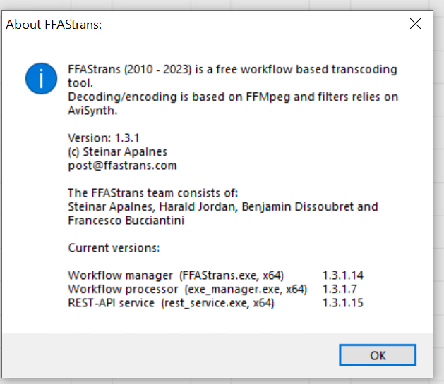

Hi Team!
As of recent, the watch folders within our workflow have begun to randomly not pick up all files that are placed into the folder whenever we place files in the folder in batches. For example, we'll put a batch of 4-5 files into the watch folder in one go and all will be picked up and proceed through the workflow apart from 1 or 2 which are left in the folder. We noticed that this behaviour is quite random as sometimes everything is picked up and processed without any issues but other times this will occur. Re-placing the file into the folder does allow the file to be picked up and worked, however we want to avoid having to do this every time this happens to a file.
We have restarted the FFAStrans machine, alongside the machine that is used to place the files in the watch folder, in hopes that this would resolve the issue but post restart, this would still occur at random instances.
One thing to note is that we noticed that the filenames that do not get picked up by the watch folder appear in the "def_log" Logs however doesn't appear in the "monitor" Logs.
I have attached screenshots of the version numbers of all softwares we are using alongside the locations we are looking in, in terms of logging.
Are there any methods of troubleshooting we can try to resolve this?
- monitor.png (12.49 KiB) Viewed 5301 times
- def_log.png (18.45 KiB) Viewed 5301 times
- Image20260209171126.png (106.44 KiB) Viewed 5301 times

was waiting for steinar but he didnt have time yet to look into this. You have a pretty old version and there was lots of changes in this area so it is good to upgrade if you can.

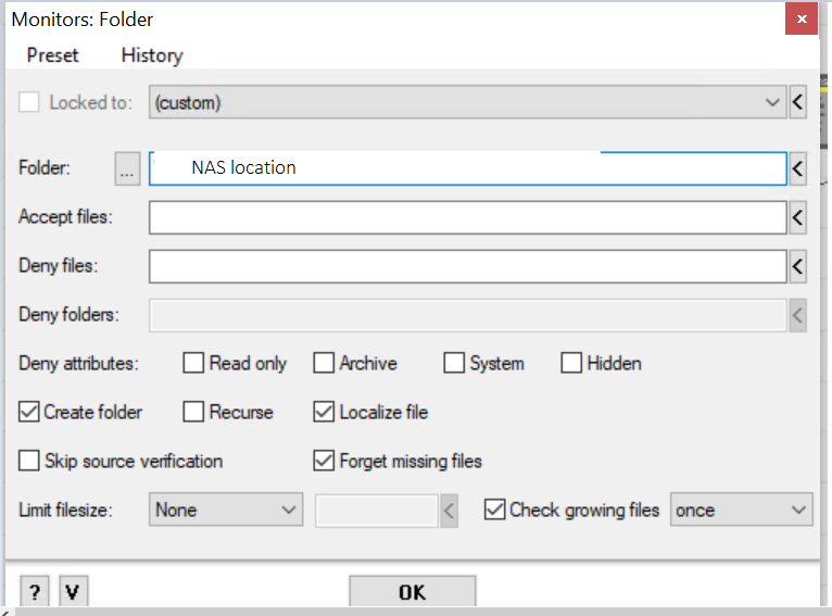

I have attached a screenshot of our monitor settings and regarding how the files are being put into the watch folder, we are performing a manual Windows copy of the file from a FTP to the watch folder using a Windows machine that has access to both locations.
One thing to also note, we are running the exact same workflow on a different instance of FFAStrans on a separate system that handles an identical workload to the instance of FFAStrans we are having this issue with, however we haven't noticed this issue on that machine. Both systems are identical in specs and storage too so we are really stuck on what is causing this.
Do let us know if you or anyone has any other ideas and I look forward to hearing back from you!
Thanks for the suggestions! Unfortunately these haven't been able to resolve our issue.
While we have considered upgrading to a newer version, we cannot at the moment as we run a critical service using FFAStrans within our pipeline and so we would need to plan a window to complete the upgrades to ensure all aspects are checked and working, which isn't possible for us at the moment.
- monitor folder.png (70.82 KiB) Viewed 5264 times
Re: Watch Folder not picking up all files when a batch is placed in folder.
Thanks for the details and sorry i mean "check" skip source validation, not "uncheck".
The "Localize file" is something i never used before, @admin to tell if it can influence this situation or not.
I'd really like you to test if the "Source verification" is the problem. However, you normally need this checked to support windows copy (the file size does not change and date handling varies on different storage types, so "open the file" is the only reliable way for ffastrans to check if its finished).
What you can do to still give it a test is first "Copy" the files into a non watched temporary location next to the watchfolder and then "move" the files to the watch.
