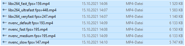

Comparing x264 and nvenc encoding is not simple at all, here look at my results, all of them used about 50% of the nvenc chip (in case of h264_nvenc codec) or 100% CPU (in case of x264). Command used was ffmpeg -i INPUT -c:v libx264(/h264_nvenc) -crf 35 -preset PRESET OUTPUTFILE.mp4
Harware: CoreI9-9900K and/or Nvidia A5000
michael85 wrote: Fri Oct 15, 2021 11:29 am ...180 frames per second ... was totaly bored with a usage of 5% for encoding.
This doesnt work really, except you encode a very small resolution like 320x240 and limit the encoding speed to 180 fps. My RTX5000 uses 50% of the NVENC Chip when i encode fullhd in full speed usually. I never saw 100% NVENC usage for a single file/stream. Maybe you looked at the GPU usage instead of what they call video_engine usage (the NVENC encoder chip)?
michael85 wrote: Fri Oct 15, 2021 11:29 am So I think a Geforce RTX A5000 would be a waste of money for my workflow.
I think so too... honestly i expected much more from it. Stick to consumer cards if you dont need to do multibitrate live encoding.

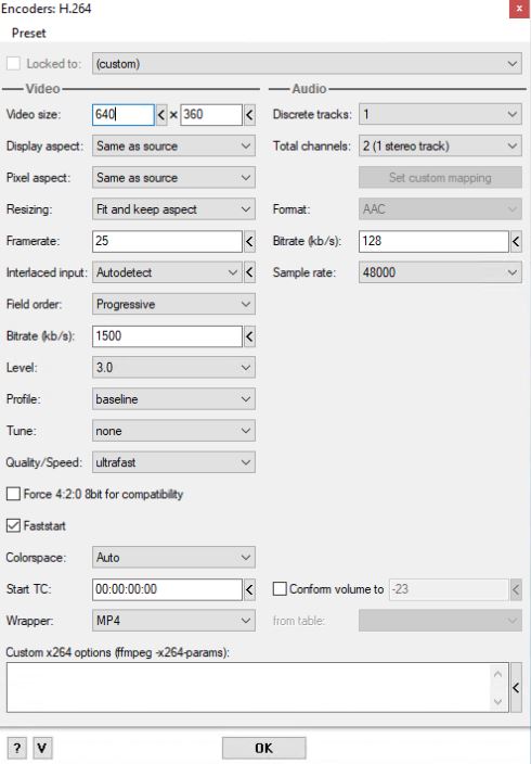

Yes, I'm encoding to a small resolution (640 x 360). Maybe this is the reason why the usage of the GPU is that low. See my Screenshot attached.

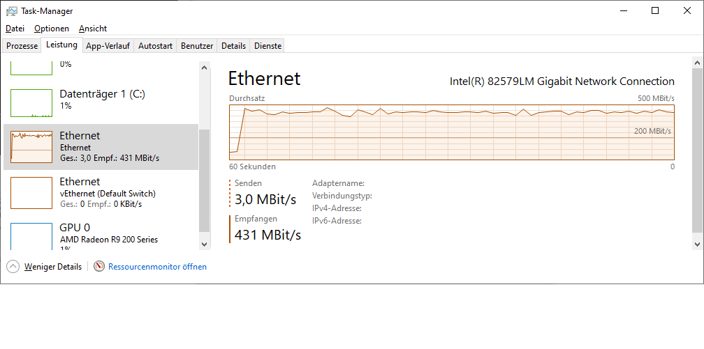

Seems you misunderstood my last post. Network usage is during encoding at nearly 100%. I usualy encode file with a duration of 1 hour. When the encoding starts, I have a very high network usage. After a while the network usage goes down to aprox. 50% without slowing down the encoding. Probably there is enough in the cache!? I dont know how exactly FFAStrans handle (caches) files for processing from a network location.
Thank you for the hint with the deliver processor before the encoder processor. This works very well. Unfortunately my files are to large to have a benefit by copying them to a local HDD.
I have played a little around with x264 and I must revoke my statement regarding x264 from my last post. On my old hardware it speeds up my actuall workflow in encoding processor for +50 frames per second.

Sorry that I did not explain this in detail. I got +50 frames compared to my old workflow. I have only changed the encoding processor from "basic h264" to a custom ffmpeg encoding processor with this values:
-vf "scale=iw/3:ih/3" -b:v 1500k  -b:a 128k -c:v libx264  -preset ultrafast
The h264 processor used befor had these values:

What i dont understand from your network utilisation is that it should be stable throughout the whole transocding process. There is no caching involved at all, look at the RAM usage of ffmpeg.exe when you run a transcoding. Well OK, the OS can and does cache data that has been retrieved from NAS but this is only helpful when you read a file more than once, which does not happen in a normal ffmpeg encoding scenario. Anyway, if you underly the OS caching situation, what you see is transcoding progress but at the same time "no network" utilisation at all.
Your situation is the other way around, you see first 100% usage and then it drops down to the actually used bandwith. One might argue that ffmpeg needs to parse through the whole file in order to get the index but this does not cause 100% usage, instead it causes about 20Mbit for about 20 seconds before the transcoding progress even starts (assumed input file 50Mbit and 1 hour, MXF format, frame wrapped XDCAMHD).
The only thing that could cause a short burst of network usage at transcode start would be something like a really long GOP at start, but i don't think that is the case for you. (which format you are decoding anyways?)

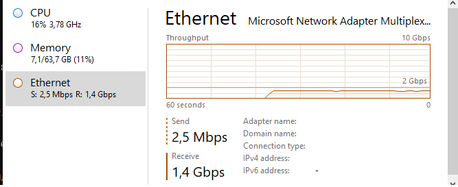

Here you see some libx264 -preset veryfast -s 640x480 encodes at 1 G and 10G connection, note that the network utilisation is stable from start until the end of the transcoding process. Note that the 10G Server also has much faster and newer CPU's, and unfortunately i cannot test how it behaves with 1G because i have no 1G storages available.
By the way, another nice benchmark is "reading only" with ffmpeg, using ffmpeg -i %sourcefile% -codec copy -f null - ...this should read at around 95% of your available Bandwith.
After all as you see, it runs at 450 Mbit for me, so network is not my bottleneck, it is the CPU frequency in fact. On this machine nvenc could really speed up the processing because it is only 2.2Ghz processor :D
