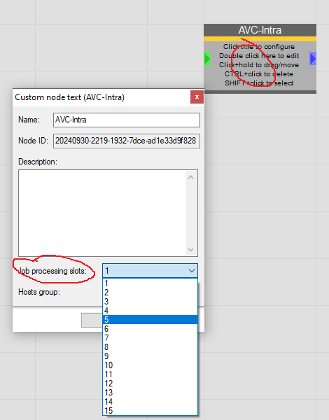

You cannot limit a workflow like this. The closest (without adding another host for this one workflow) might be to use the feature where you tell a node (or even all nodes in your workflow) to occupy more slots in order to limit the total executed nodes per host. But it's limited occupy 16 slots, so if you have configured your host to 24 you will still have 8 free slots to use. Please also note that an incoming node with higher priority set to occupying more slots (above just 1) than what is available, will hold until the number of free slots is reached.
Just double click the node to configure the "Job processing slots" setting: Hope this helps to somewhat accomplish what you need.

If I understood @Steinar correctly, if I lower one of the machines to 16 slots and on the process step occupy the 16 slots, this will prevent the machine from starting other jobs, right?
It's not ideal, since it takes the machine "down" for a few hours while it does the demanding GPU process but for I'll test it...

So knk, it's basically the same use case as we have where we use FFAStrans to drive Whisper transcriptions. If you leave your hosts at 24 slots and set the GPU intensive node to utilize 13 slots, then you will still have 11 free slots for other operations but not enough room for two 13 slot nodes on one host. This is how we utilize this feature and it works very well.
