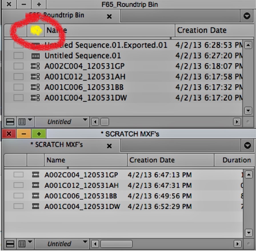

hey @ghatis ..the aaf you uploaded, after importing to mcp, lots of stuff appears in the bin but no timeline is opened. also i am not able to find a sequence in the bin. Do i make any mistake here or are these just huge aaf but don't contain a sequence?

emcodem wrote: Fri Oct 04, 2019 9:31 pm hey @ghatis ..the aaf you uploaded, after importing to mcp, lots of stuff appears in the bin but no timeline is opened. also i am not able to find a sequence in the bin. Do i make any mistake here or are these just huge aaf but don't contain a sequence?
Hi Encodem,
Have you look at the bottom of the name column? I think the sequence is drop in first and after you have all the master clips.
If you double clic where I show you in the attached file, you can sort your bin with sequence in first .
cheers.
Hi Emcodem
you should have a sequence. thanks to momocampo tip you should be able to find it quickly.
Let me know :)
