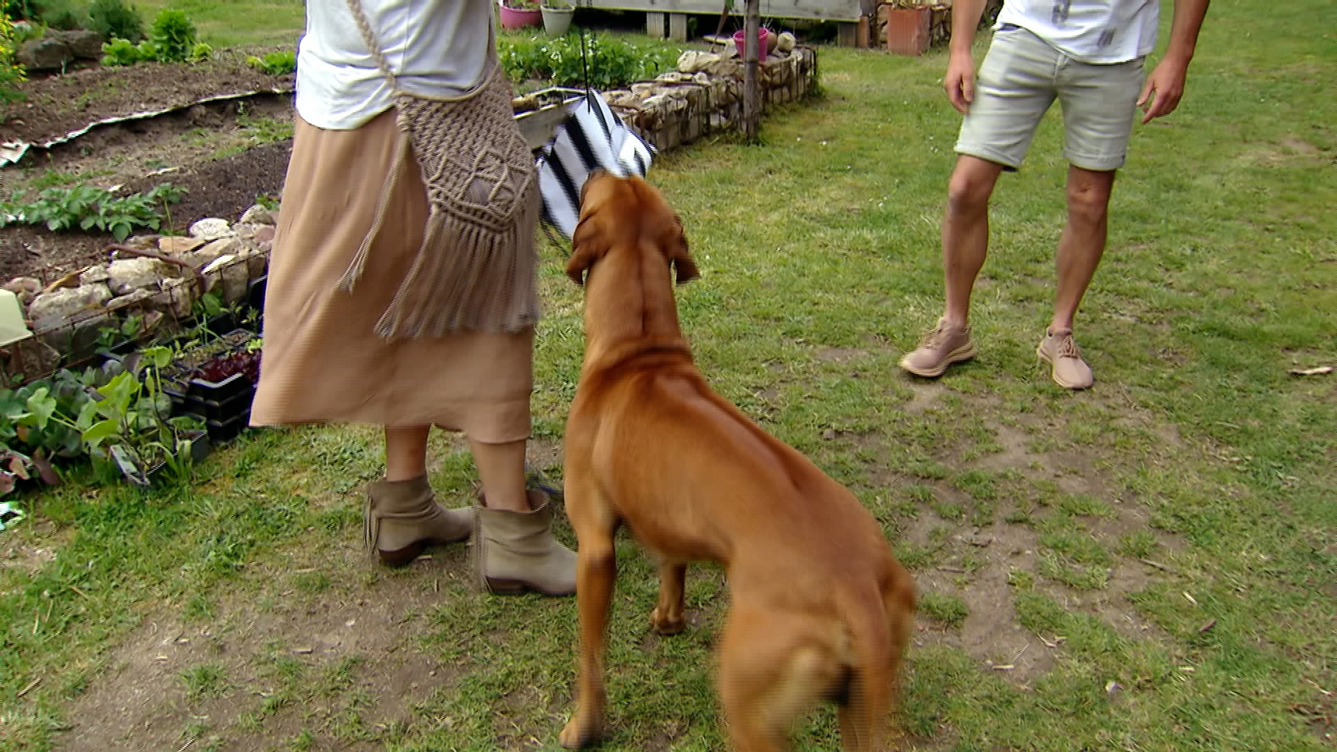

I tried qmin5 qmax23 and compared in Premiere switching videotracks. And you can clearly see that FFMPEG exposes more blocks in the dress. But the complete picture gets less detail al together!
- Blocks_FFMPEG_qmin5-qmax23.jpg (1.83 MiB) Viewed 18616 times
- Blocks_Adobe Encode.jpg (1.57 MiB) Viewed 18616 times
