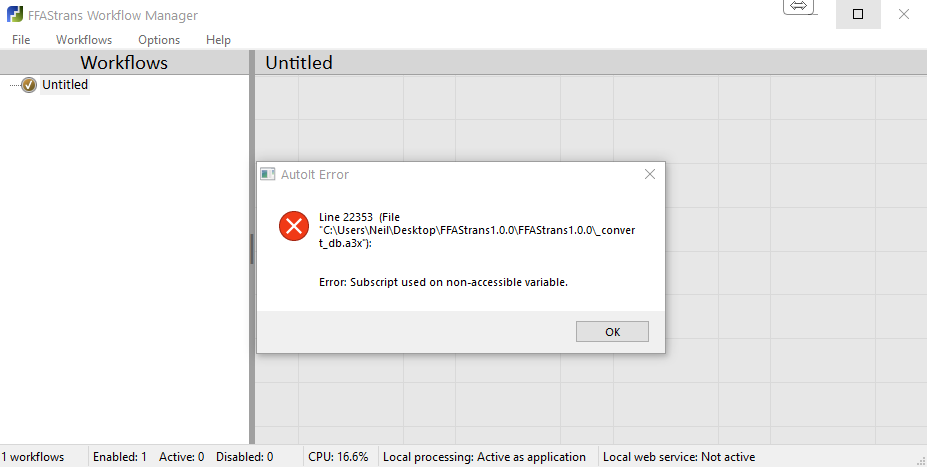

Extracting the main package and adding the contents of the patch to its folder and then trying to run the exe gives me this error.
Re: Occamy.C Trojan detected in FFAStrans.exe
This should not be a problem as you don't have any old database to convert.
The exe files will still be detected as various malware/viruses by some anti virus systems. The only difference between the old files and the new is that they have been self signed. This is not very trustworthy but some anti viruses will see this as "good to go". So as I wrote, it's very difficult to fix this 100% cause it's not a bug in the software, but rather over eager anti viruses with allergic symptoms.
The reason I don't exchange the files in the main package is that I need some feedback on these new files whether they all work fine or not. Also, most people don't have issues with the main package. At work we use Symantec endpoint and it has no problems with the main package files. However, I will exchange the main files when I get some feedback that the new files are OK.
