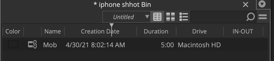

Hi emcodem all three files if imported on avid are correctly linked to the TEST AAF.mxf on my desktop, the problem is that audio tracks are presents but mute and on my Avid bin the linked file is alway called Mob as you can see in the screenshot, and not TEST AFF ( original file name of my mxf )

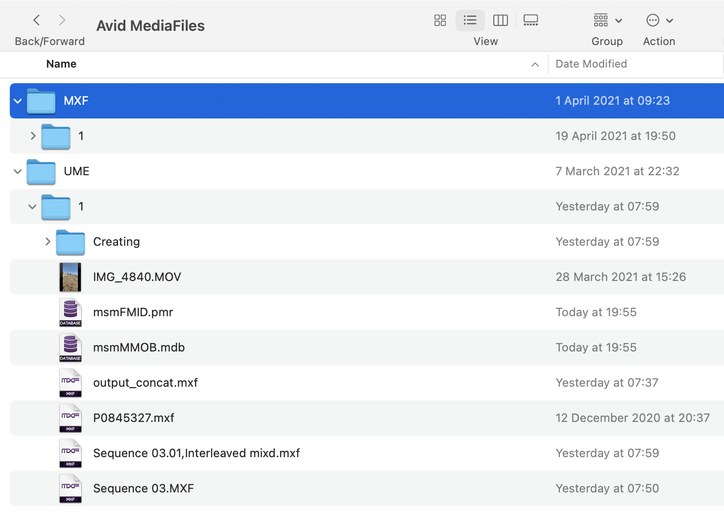

here below an example of the Avid Mediafiles folder
Screenshot 2021-05-01 at 20.00.26.png (246.02 KiB) Viewed 15848 times
Re: create aaf from single OP1a mxf file
OK it makes sense.

Can u try this and tell me your results please? In difference to all files before, i did set the value for "audio length" of each track to 125 instead of 0.
TEST AAF_length125.aaf
ring4life70
Posts: 62
Post by ring4life70 »
hi emcodem, and thanks again
with this new AAF, the file name in the bin is alway mob, but now in the file is present the first audio frame, the problem now is that If I move the mxf file from the Desktop to the UME folder, and try to relink the mxf using the aaf file, Avid crash, I don't think this is a problem related to your aaf, because I have the same issue if I try to link the mxf file using my old original aaf ( the first uploaded on your folder).
