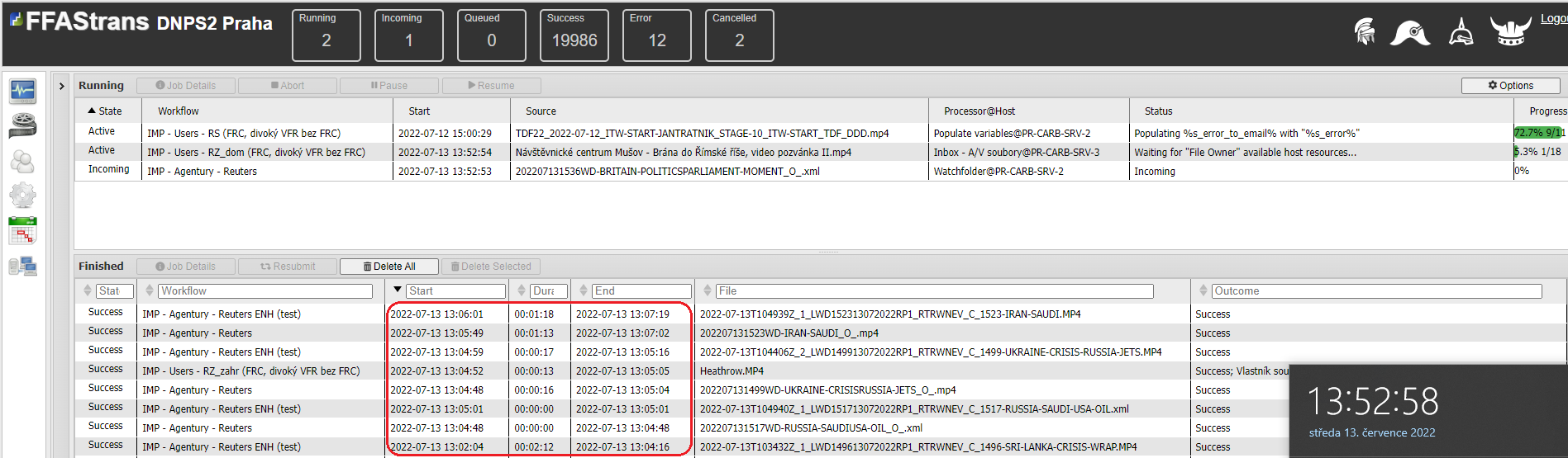

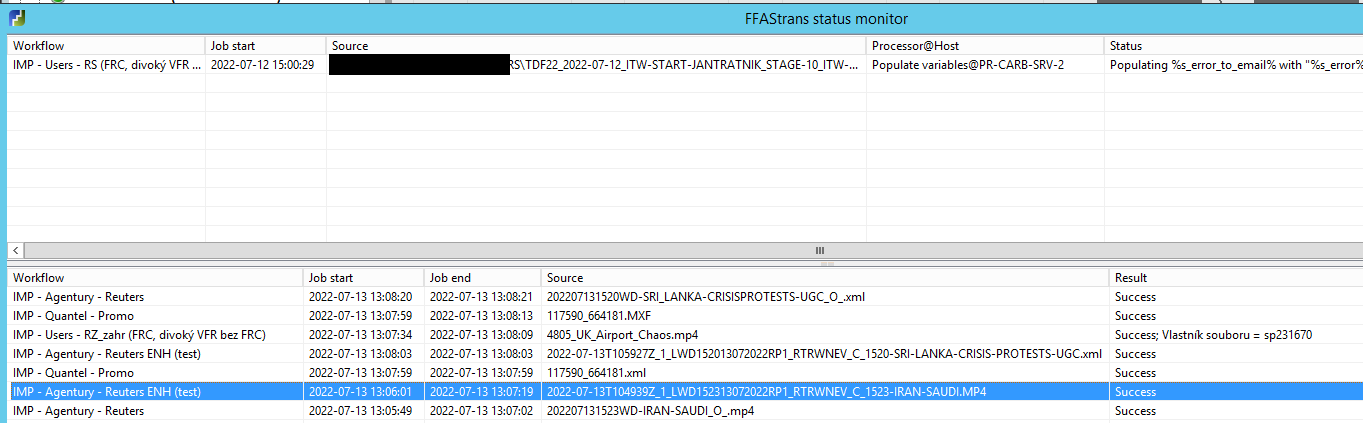

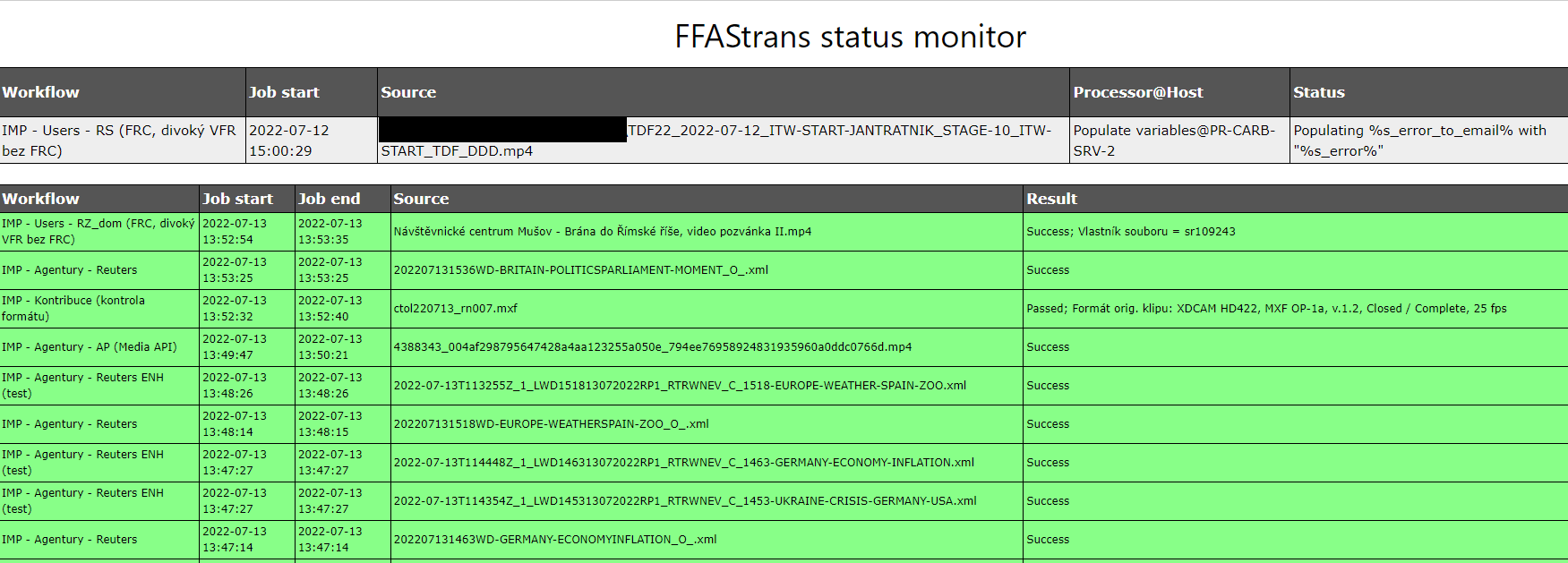

Well, I have bad news for you ... the issue is back again :-(
Since 13:07 finsihed jobs are no falling down to bottom list in WebInterface. But FFAStrans native Status monitor both the app and the webpage are showing them normally. See screenshots.
As far as I can judge the filenames of jobs , which are visible in Status monitor, but invisible in webinterface, are quite normal.
FFAStrans Status monitor web_220713_1353.png (70.53 KiB) Viewed 11133 times
FFAStrans Status monitor app_220713_1306.png (30.89 KiB) Viewed 11133 times
FFAStrans WebInterface_220713_1353.png (137.8 KiB) Viewed 11133 times
BR,
Silicon
Re: Two small bugs in Webinterface 1.3.0
Great screenshot, thanks!
As i cannot reproduce, could you please send the a from webinterface? You know, just stop the webint service, start commandline:
c:\webinterface\server.exe > c:\temp\log.log
And wait until a job finished and is not showing on the webint gui. then stop server.exe and send me the logs please :D
