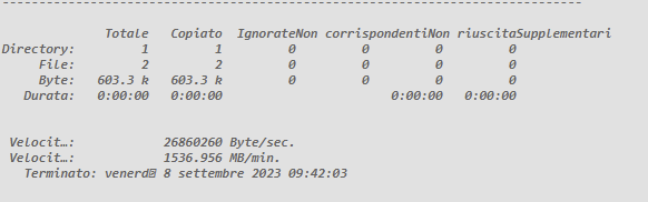

Hi emcodem here below the screenshot
Screenshot 2023-09-08 at 9.34.42 AM.png (18.96 KiB) Viewed 13424 times

Just perfect. Sorry i was not aware that robocopy could change language depending on the OS language.
However, it should be easy to solve for you: in the populate processor, you find 2 times:
$regext("%s_stdout%","Files :.*?\d+.*?(\d+).*?\d+")
Actually it is not 2 times the same but the inner parantesis () are on different position in order to select a different number.
What this does is to look for a line in robocopy output that starts with "Files :" followed by 3 numbers, Totale Copiato and Ignored (Skipped).
As you can see, in my output (english version), the Line starts with "Files :" but in your it starts with "File:"
In the populate Processor, you will need to Change the word "Files :" to "File:" and it should work for you. Notice the space before : - in my Version there was a space but not in yours. I don't know if there is really no space between File and : in your version, you need to check.

Thanks Emcodem, everything is fine now, I can confirm you that in my version there is no space between File and :.
