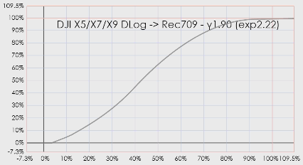

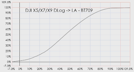

I ran it through the analyzer and indeed I was right in not releasing the LUT I made a long time ago for D-log.
Screenshot from 2024-07-01 12-50-35.png (24.18 KiB) Viewed 11449 times
Screenshot from 2024-07-01 12-52-34.png (27.08 KiB) Viewed 11449 times
The first one is the one made by the manufacturer that you shared, while the second one was the one we produced initially when we didn't have any reference.
As you can see, the one from the manufacturer starts much higher with the blacks, thus preserving them and it's also shifted to the right with the knee start level raising a whole stop later.
Both flattened at 6 stops which is 100 nits for BT709 SDR.

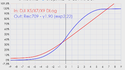

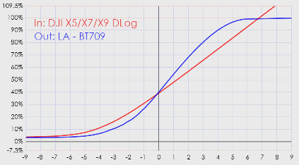

The final LUT result was therefore different:
Screenshot from 2024-07-01 13-01-13.png (22.03 KiB) Viewed 11449 times
Screenshot from 2024-07-01 13-01-23.png (23.64 KiB) Viewed 11449 times
For reasons everyone would probably understand, we can't ship any manufacturer-created LUT, so we had to create our own which are shared publicly for free just like FFAStrans.
