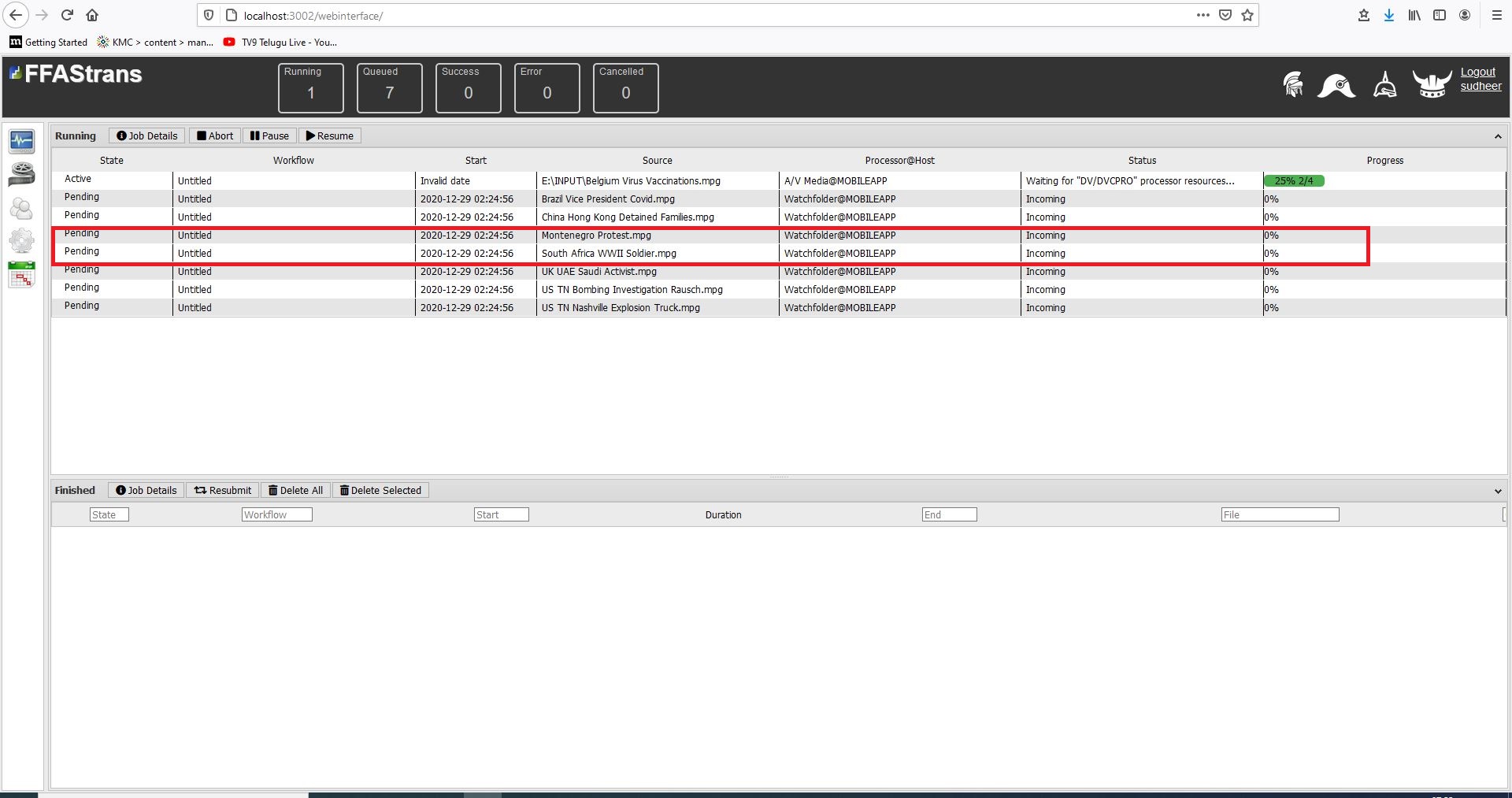

How can i Movethe file to top and bottom of my queued files in order to give the priority for the conversion?

my Problem is how to select the file as a priority. i am using Webinterface_1.1.2.1. in that if i click the right click it is showing only browser options , not showing the priority options. here i attached a image for your reference, in that if i would like to give priority for the files which are marked, how can i give the priority using Webinterface_1.1.2.1.
Please explain me the process.

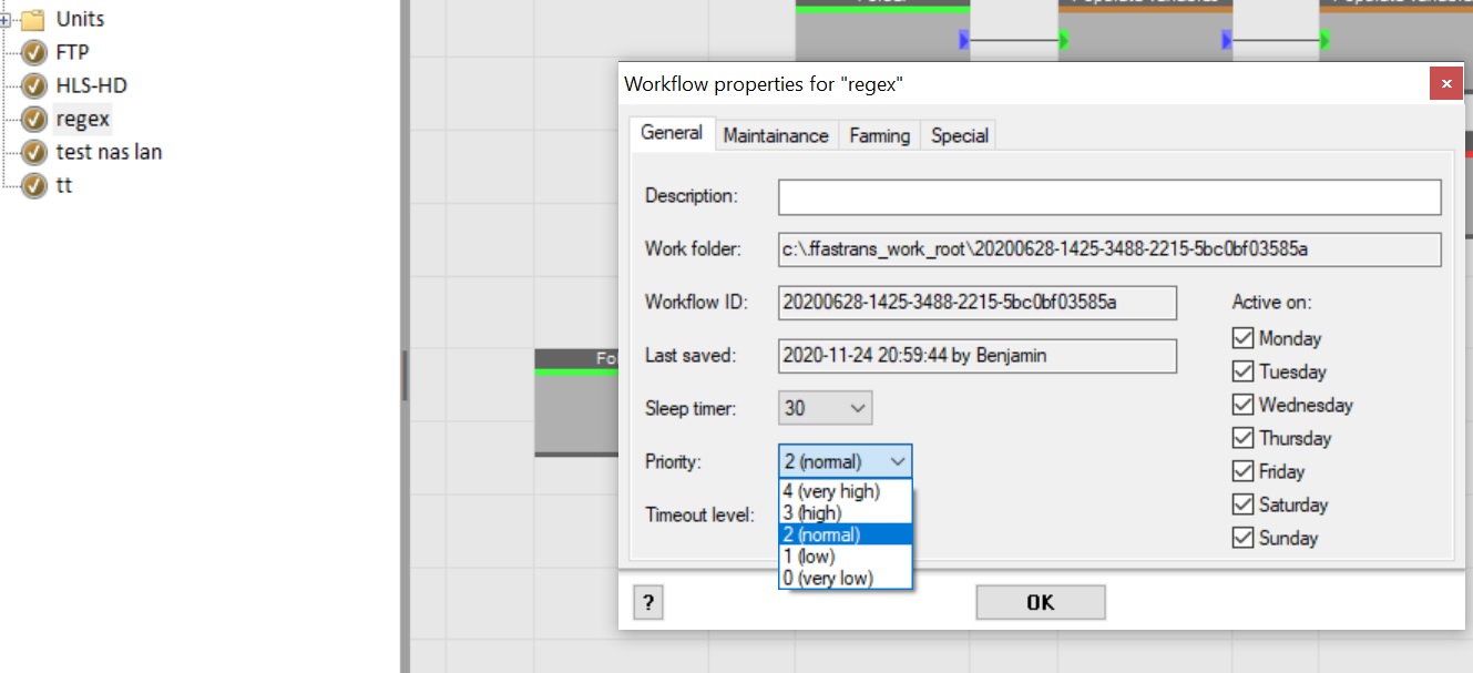

You cannot select a priority from the webinterface. You have to set a workflow priority from the FFAStrans gui.
The priorities are possible between workflows, not for files inside the same workflow.
So, if you want your 2 files have the priority on others, you have to create another workflow and set a higher priority than the first workflow.
In this case, when the 2 priority files will process, they will take the place of the others.
Hope you understood.
cheers.
cheers.

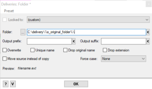

I have another doubt, If i dropped the folder in source monitor, i am getting only files in output folder.
But I need the output should contain the same name folder which i dropped in source folder. how can i get it ???
Re: Queue Monitor
Hello Sudheersree4u and happy new year !!
Very easy to do. You just have to specify the original output folder variable before your destination folder, like that ;
You will have your delivery files into the original folder name.
Cheers
Cheers
