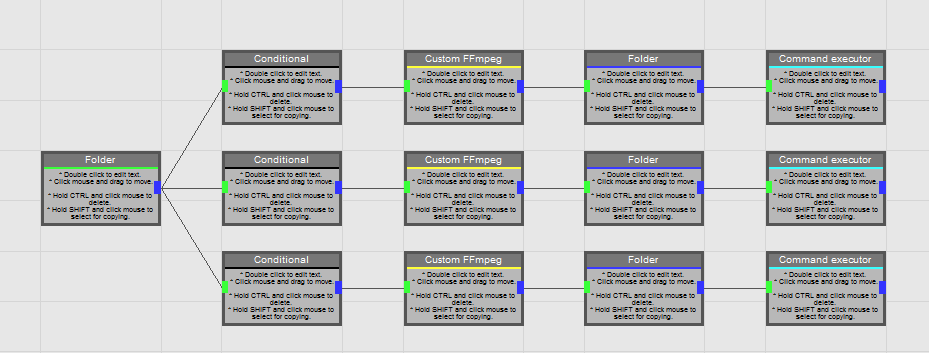

Now, FFAStrans can somewhat help you in some cases because it has the inbuilt "Conditional"-node that lets you extract media information and use it to alter your workflow. Please read the help section for that one. The media variable %i_a_streams% can be used to determine the number of audio streams from your incoming media. You can f.ex. attach 3 "Conditional"-nodes to you mointor with the following configurations:
Conditional node nr. 1:
If %i_a_streams% = 1 Then -> (add nodes to extract and encode 1 audio stream"
Conditional node nr. 2:
If %i_a_streams% = 2 Then -> (add nodes to extract and encode 2 audio streams"
Conditional node nr. 3:
If %i_a_streams% = 4 Then -> (add nodes to extract and encode 4 audio streams"

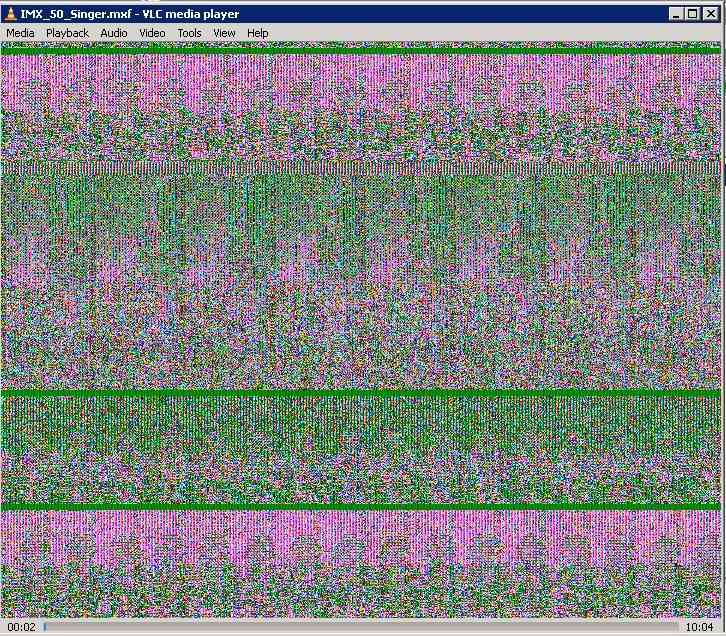

I am getting output as per below screen shot.
I have used below command.
-map 0:1 "%s_job_work%\%s_original_name%.wav" -f rawvideo -pix_fmt uyvy422 -an
%ComSpec% /c ""%s_ffastrans_dir%\Processors\mxf_tools\raw2bmx.exe" -o "D:\Uncompressed MXF\Outbox\%s_original_name%.mxf" -a 4:3 -c 10 --unc "%s_source%" --wave "%s_job_work%\%s_original_name%.wav""
Is it something related to -pix_fmt? I had also tried -pix_fmt yuv422p, still same issue.
Please suggest.
Vijay
Re: Uncompres MXF OP1A or Lossless j2k with MXF wrapper
Is your source real SD? I see from your screenshot that it might be IMX50 which is not SD unless you crop 32 pixels off the top using ffmpeg. Maybe raw2bmx mess up because of the IMX resolution which is 720x608 in pal and 720x512 in ntsc. I'm just guessing here... :?:
