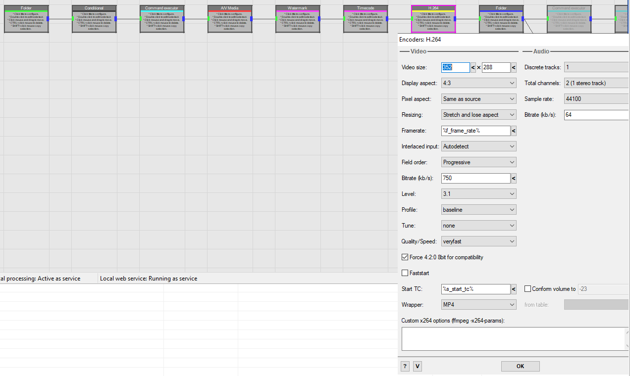

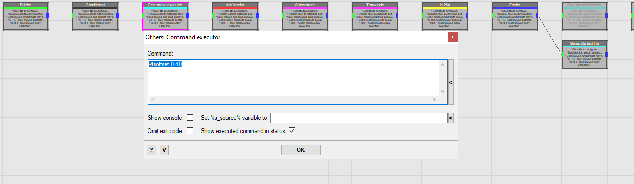

Hi Emcodem, I really appriciate your help on this but I'm still couldn't fix it.
workflow with command line proccessor
CMD 01.PNG (47.86 KiB) Viewed 16353 times
CMD 02.PNG (26.32 KiB) Viewed 16353 times
workflow without CMD and the Params added in the bottom box but it gives an error on the H264 node.
no CMD 01.PNG (50.99 KiB) Viewed 16353 times

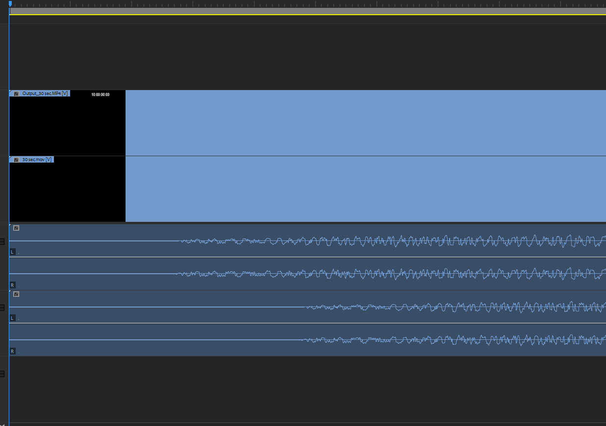

by Mahmoud Rady
Output
source is in the upper audio track
FFAStrans output in the bottom audio track
Posted: Thu May 28, 2020 6:45 am

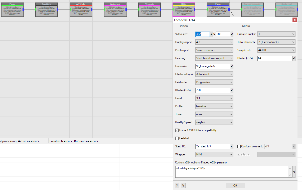

You need to use a "Custom ffmpeg" processor instead of the h264 encoder node. There is no way we can make this work with the predefined h264.
in the custom ffmpeg's processor configuration you input this:
-f mov -vcodec dvvideo -vtag dvcp -pix_fmt yuv420p -s 720x576 -b:v 25m -qscale 15 -acodec pcm_s24le -ac 2 -ar 48000 -af adelay=delays=1920S
let me know your results please!

Thanks for your reply... Here is the final output after adding -af adelay=delays=1920S
only the left channel in the last track has shiffted slightly to the right. I want them to be synced perfectly to the first track.

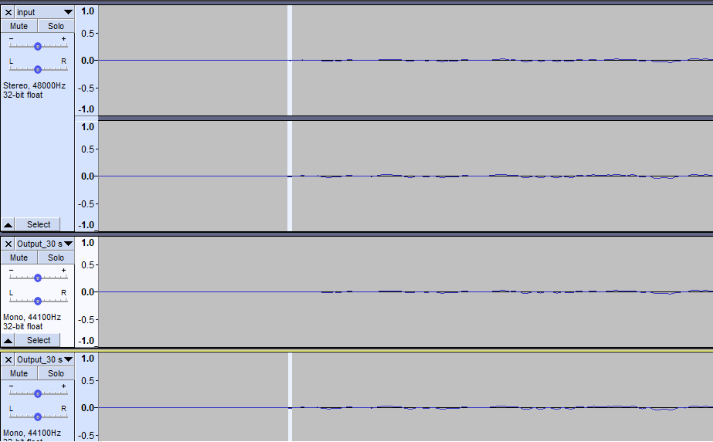

Posted: Tue Jun 02, 2020 4:45 am
Hi Mahmoud,
thanks for the files, they are just perfect samples for playing with this.
Unfortunately in my first try, i don't see the audio being shifted
My method is to first extract the audios from the files and save them to wav, e.g. this command:
ffmpeg -i "C:\Users\meme\Downloads\input_30 sec.mov" -vn "C:\Users\meme\Downloads\input.wav"
Then i compare the 2 wav files using audacity. What i see this way is perfect alignement.
Also, when using some player that shows me the VU, i see exactly the same VU power in both files when i compare frame by frame. The thing that both of my measuring methods have in common is that it is always ffmpeg libraries that do the decoding.
Are you using different tools for measuring or are you using always the same tool (Permiere?)? ...different decoders might show different behaviour when decoding, especially when using delivery formats like mp4/mov/h264/aac.
