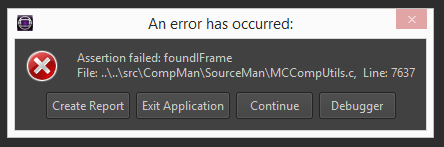

I just tested Emcodem's code for the proxy and while it does AMA-Link successfully the consolidate failed. :(
FullDmp_2019.08.12_11.54.txt
