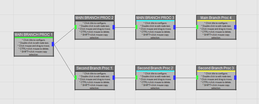

sorry, i didn't quite get it... typically i like to explain stuff using a minimal amount of words but this time it might need some more explaination :-)
Up in front, the V1 Webinterface will group jobs and their branches while currently you see one line in the monitor per branch instead of per job.
Is it possible for you to explain a little more or draw a short picture about what you mean?
Also, can it be that you mix up the meaning of processor and job? Or are you not talking about the Main Job View of the webinterface but the job log window?
Just to clarify the naming, in this picture we have
-) one workflow
-) 2 branches (top is the main branch)
-) 7 processors, main branch has 4 processors, secondary branch has 3 processors

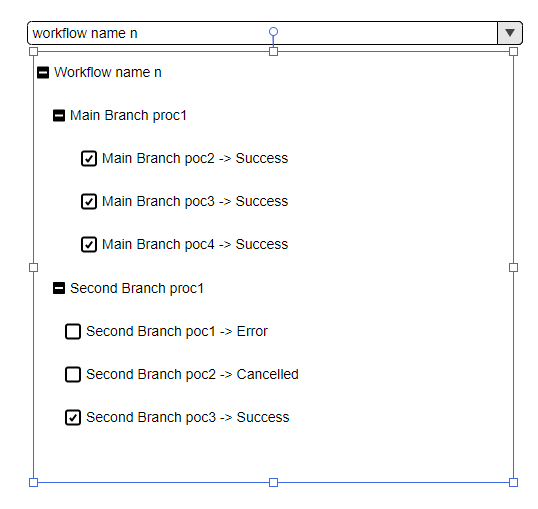

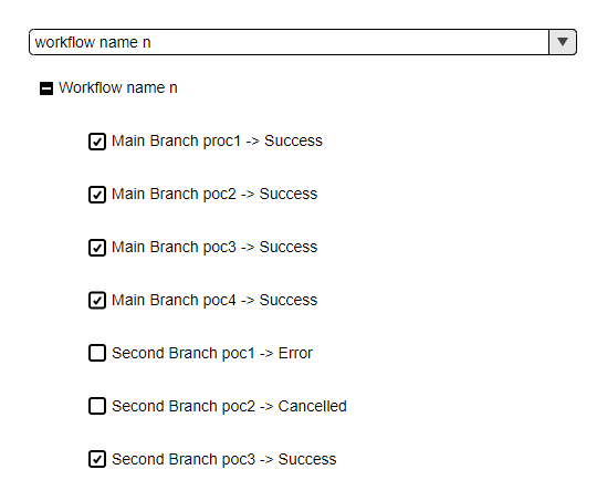

Posted: Mon Nov 18, 2019 4:56 pm
by jerrysub
what do you think about this?
maybe this is more logic:
