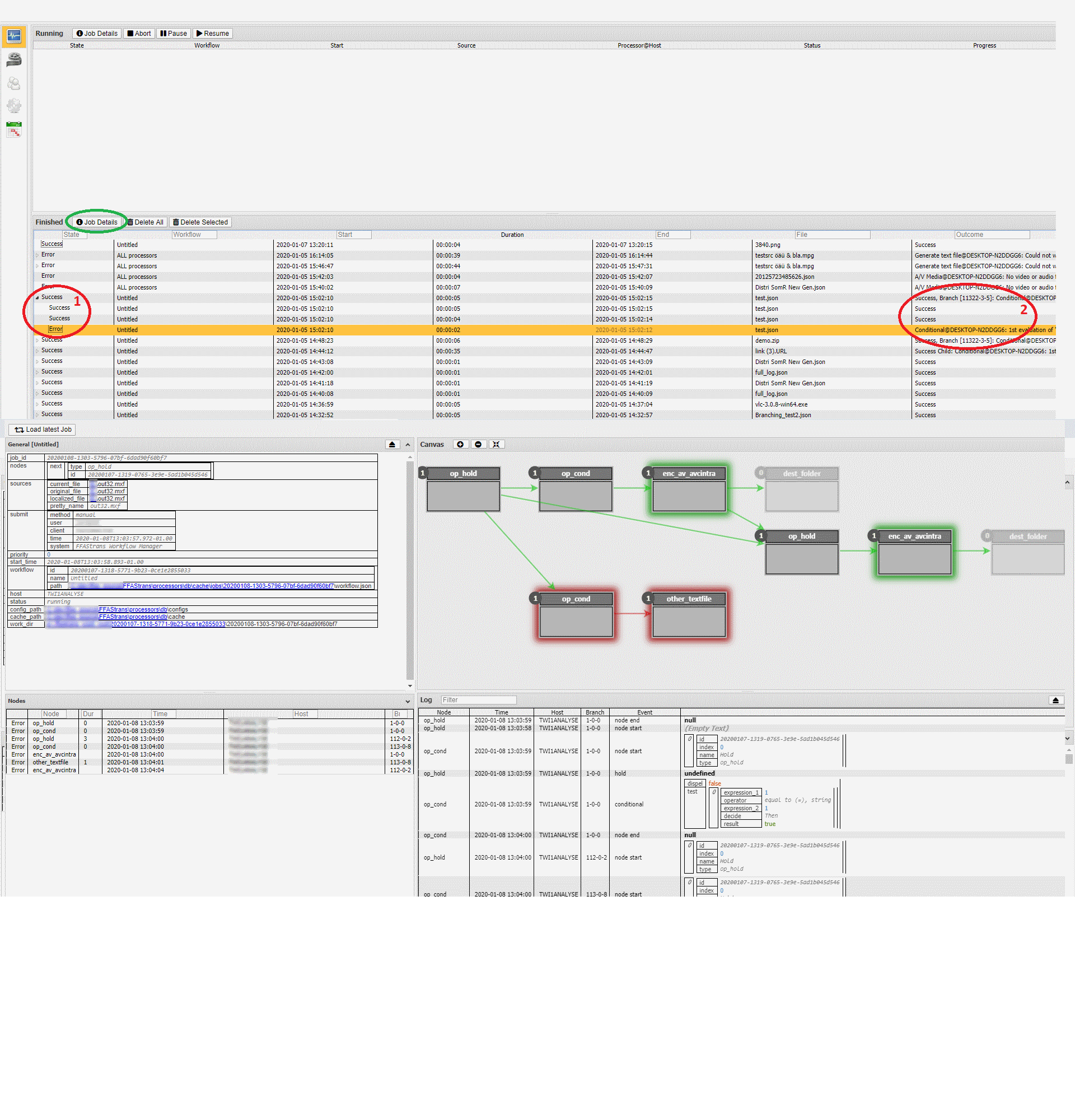

Hey @jerrysub
here finally a promised screenshot of the newest thing. Upper screen shows branches are now "grouped" by their job, you can "expand" a job and see the branches. The red circle 2 shows that all error msgs of all branches are collected in the main branch so you see all errors collected.
Then we have a new "job details" view, bottom screen. In the canvas, you see green nodes (green is blinking actually) which are still running and red nodes that failed.
This is the main thing for the new Version, it will allow you to resubmit as requested.
The only thing i need from you is to tell me which "file" you typically resubmit, i guess the original source file. But how do you decide which processor to resubmit it?

emcodem wrote: Mon Dec 16, 2019 2:41 pm Hey @jerrysub,
sorry your message somehow did fall under my radar.
It is in deed a lot of work to build the new job details interface, but i think ffastrans deserves a nice UI for job management and now as steinar and me work synchronized we even have a lot more possibilities than before :-)
When you want to "redo" a job at a failed step, how can i imagine what you are doing? Do you always submit the "original source file" to the failed step or how do you decide which source file to submit to the failed step?

emcodem wrote: Wed Jan 08, 2020 12:10 pm Hey @jerrysub
depending on the branch step where it is stucked I have to choose what could be restarted but mainly if source file is still there I would like to restart the concerned jobs only from the branch.
br,
Jerrysub
