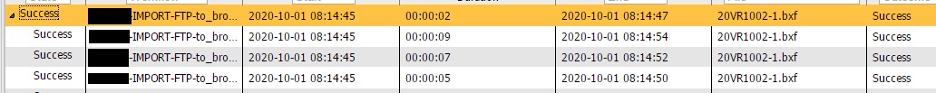

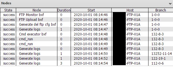

Hi Emcodem,
where could I set the column "Node" on Finished job under Job Status View?
Status View - Finished:
Job details view:
br,
Jerrysub
Hey @jerrysub,
Not sure if i understand correctly but if i did understand the answer is more kind of an explaination.
On the Finished job view, what you see is all the branches that a job did generate, grouped together.
On the Job details view, you see one more level down, all branches of the job and all nodes of each branch.
Now, the Job details view is basically parsing the job log in order to get this information while the finished job view gets it's informations from API calls. As the job log is not guaranteed to exist, i need to stick with showing the reliable information on the Job Details view.
If i would plan to show the nodes on the job history page, i would most likely introduce one more level of depth, e.g. you can expand one job to see its branches and then you can expand each branch to see the nodes it did execute.
Would this be what you imagined?
