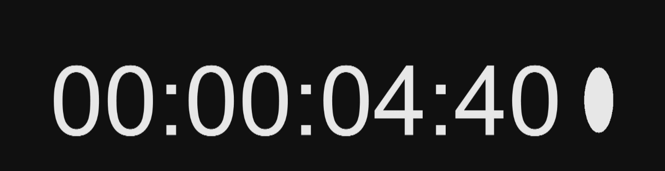

So it looks like there is an issue with Adobe Premier regarding popping sound on exporting. I will research that myself. As there has to be some kind of solution.
but there is a problem with the clip insert. Please have a look at the attached GIF. with the provided nifty software, I step through and you can see it clearly in the GIF.
Please have a look and let me know.
Clip Error
Clip Error
it is adding a frame unnecessarily. I'm not quite sure why.
