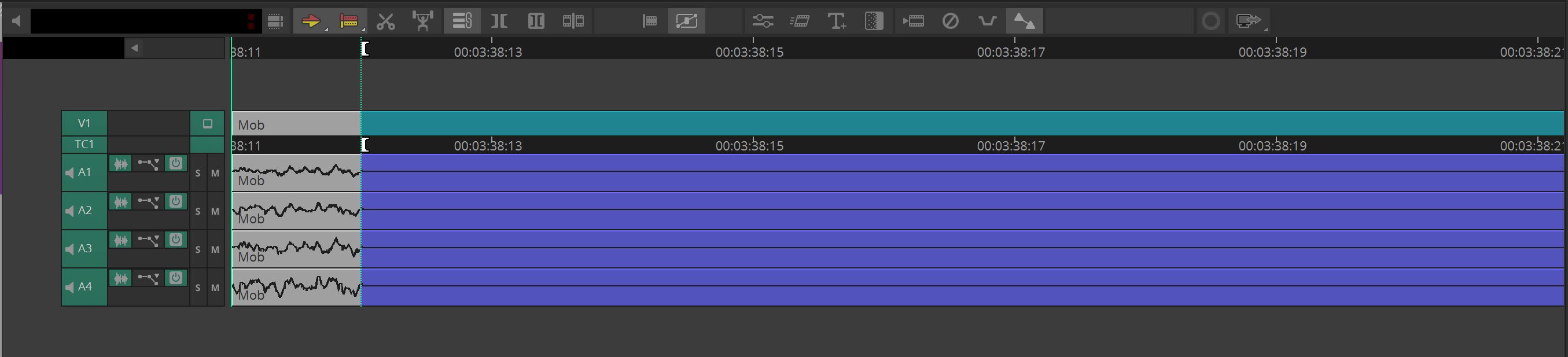

the crash problem is solved, it was my mistake, sorry, TEST AAF_length125.aaf is linked to TEST AAF.mxf on the share, and not to rdd9.mxf, the file name in the bin is always "mob", media duration is 5.00 sec. video is ok and is present for the overall duration of the media, but as you can see in the screenshot, only the first frame contain audio signal, in the remain 4.24 sec the audio is mute.

Re: create aaf from single OP1a mxf file
Ok great! thanks for confirming. I had the feeling that it was exactly like that but its good to have it confirmed.

hi emcodem, and thanks again, same result the aaf file is regularly linked to retry.mxf but the name in the bin is always Mob and only the first audio frame is played, another thing, if I copy the mxf file in the UME\1 folder, and then import the aaf in the bin, avid crash, but if I import first the aaf in the bin and then copy the mxf in the UME\1 folder, I don't have any kind of crash. :shock:
