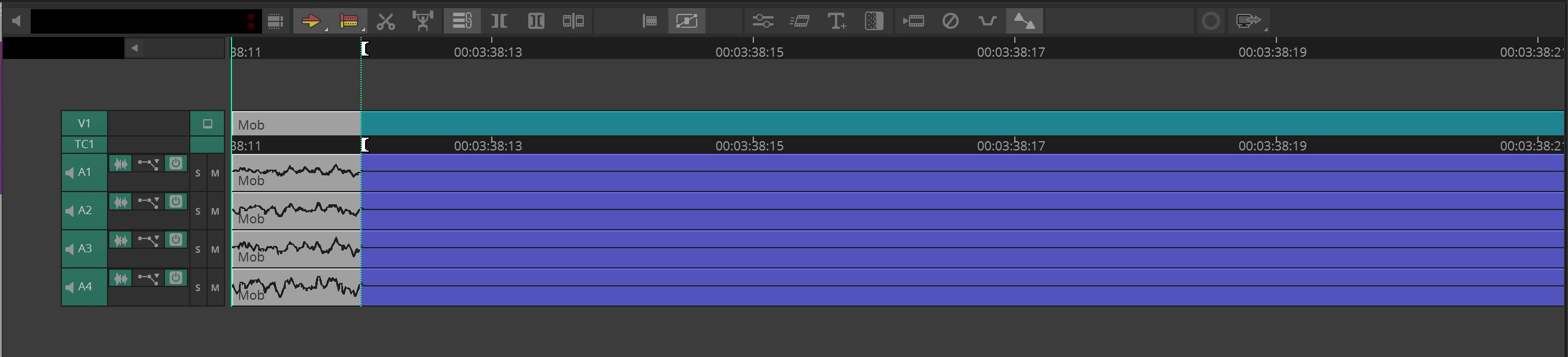

the crash problem is solved, it was my mistake, sorry, TEST AAF_length125.aaf is linked to TEST AAF.mxf on the share, and not to rdd9.mxf, the file name in the bin is always "mob", media duration is 5.00 sec. video is ok and is present for the overall duration of the media, but as you can see in the screenshot, only the first frame contain audio signal, in the remain 4.24 sec the audio is mute.

Ok great! thanks for confirming. I had the feeling that it was exactly like that but its good to have it confirmed.
