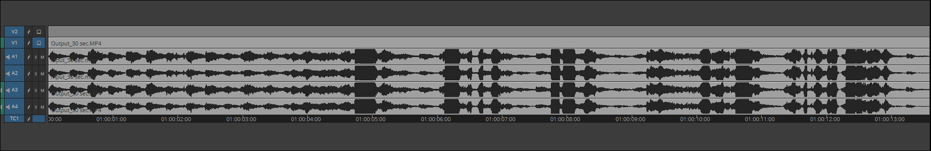

Thanks again for your help on this. The main reason for the transcoding process is watermarking the clip, the output clip “H264 or custom ffmpeg” will be used to be a reference clip to create a dubbed audio track.
The dubbed wav should be synced to the same picture. But it’s always shifted because the reference Clip is not matching the original clip
I’m Using premiere and Avid protools.

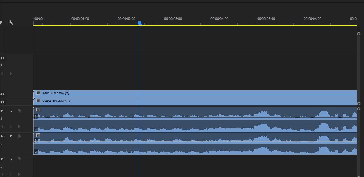

@momocampo checked your uploaded mov and mp4 files in Avid MCP and Premiere, the tracks are 100% sync.
Are yu sure you uploaded the correct files, so files where you see the audio glitch?

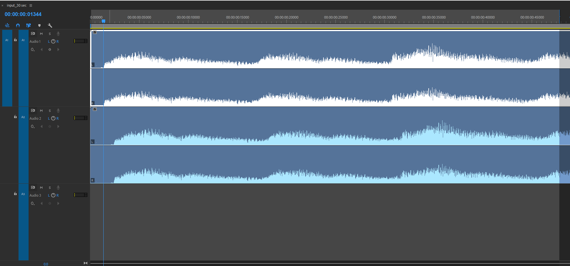

take a closer look at the first second of the file.
zoomed 1 sec.PNG (58.33 KiB) Viewed 13898 times

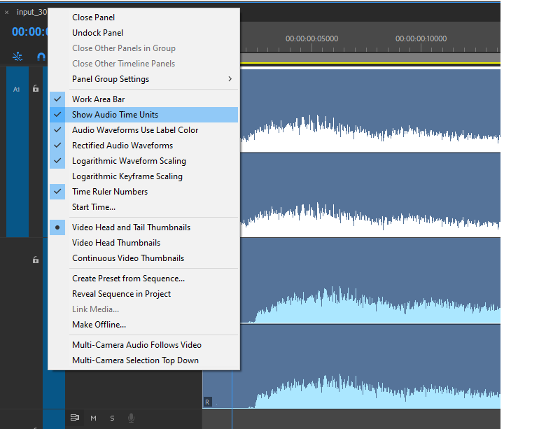

for zooming;
Show audio time units.png (31.08 KiB) Viewed 13898 times
Great, using your instructions, we were able to reproduce and see what you see.
