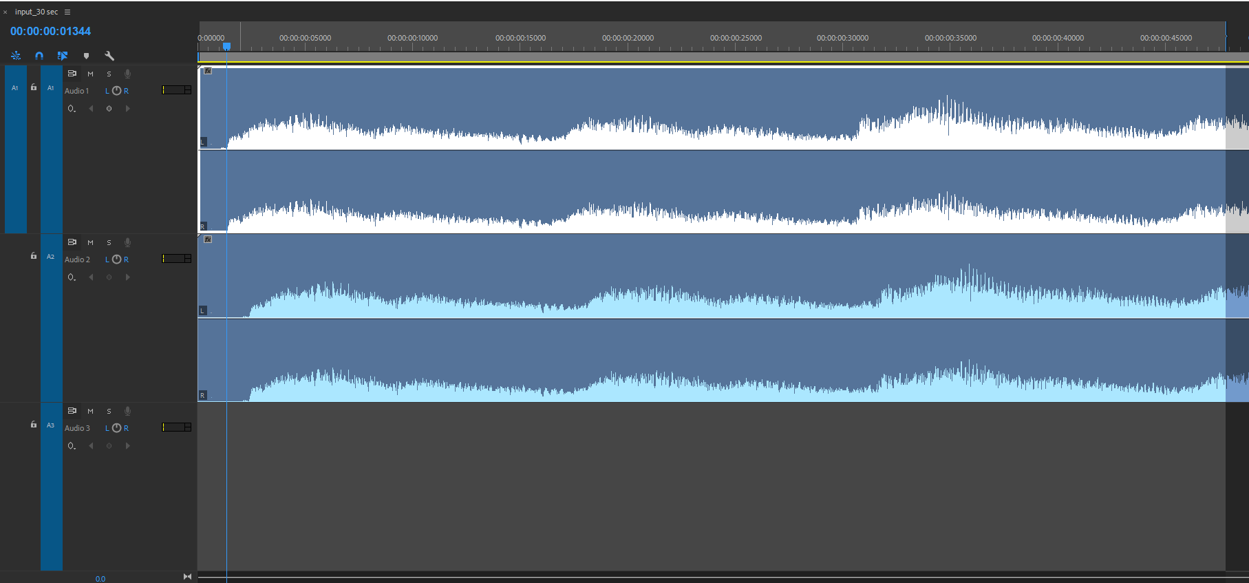

take a closer look at the first second of the file.
zoomed 1 sec.PNG (58.33 KiB) Viewed 13909 times

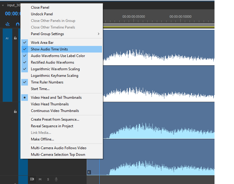

for zooming;
Show audio time units.png (31.08 KiB) Viewed 13909 times
Posted: Tue Jun 02, 2020 3:14 pm
Great, using your instructions, we were able to reproduce and see what you see.
Now i need some time to experiment with your files. By now i believe it is not the Audio you want to work with as the output file seems to have longer video than the input file. If it is like that and ffmpeg does "create" video that did not exist before, the cleanest solution would be to just prevent this.
Maybe you can work with the ffmpeg switch -shortest or such but i'll need to investigate.
Another shot in the dark is that the issue comes from the original input file having somehow variable frame rate in it, but i did not yet understand what it means when mediainfo says this line:
FrameRate_Mode_Original : VFR
Stay tuned...
