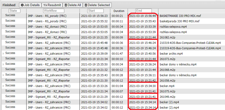

Unfortunatelly I have found another bug in Webinterface 1.2.0.1: after a while (I don't know how long it takes) the list of Finished jobs in bottom part of page becames unsorted ... it should be sorted based on End time (correct?), but it is not.
- Webinterface - Job history sorted inproperly.PNG (76.46 KiB) Viewed 16659 times

Uhhh... lemme see if i can reproduce that.
The worst issues are the ones that take "time" to be visible ^^
I've been watching the Webinterface page live now and it took aprox. 20 min. (and aprox. 30+ jobs) to get the list of Finished jobs wrongly sorted. Number of jobs processed seems to be more important that time elapsed.
I have forgotten to mention, that F5 fixes it ... but this is obvious

Hey @Silicon
i am really greatful that you submit all the anomalies you find to us, thanks a lot for it!
It was really easy to reproduce by just submitting lots of jobs for about 10 minutes, pretty obvious. I fear it will still take some time because each "test" costs again about 10 minutes but i will for sure solve this, no worries! (it's totally disturbing from user perspective^^)
@Silicon @ernie1901
Fixed, sorry for the delay. Please check out release 1.2.0.2

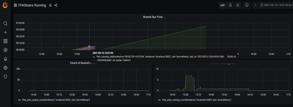

On my way on adding sophisticated monitoring, some metrics can now be polled for Prometheus/Influxdb or similar systems.
Users that have such a system already in place might want to try it out. All others need to wait until i finished the prometheus integration in webinterface
http://localhost:3003/metrics

Using those metrics, when configured correctly, the job/branch runtime can be displayed on grafana or similar systems like this:
