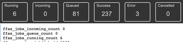

Hi @emcodem,
I think there is an issue in metrics, as "Queued" shows always zero.
Also would be awesome to have also "Error" metrics ;)
Cheers,
mrazik

@mrazik
well queued might always be zero because you dont have any queued jobs? :D Only manual submitted and API submitted jobs can actually really raise the queued count. Watchfolders basically inly raise the incoming count... Might that be your problem?
Sure Error metrics will be working soon :D

Hi @emcodem,
all jobs are manually started, queued shown correctly in webinterface, but not in metrics....

hmmm interesting that should be already working i guess, will repair (or ask in case i cannot reproduce ^^)
