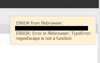

Hello Guys,
I have a small Problem.
I tried to add an UNC Path to the Webinterface but i got this error
The Path was
["A Drive on server","A"]
["\\\\IPAdress\\DRIVE-NAME\\FOLDER","A:"]
Best regards
Russ3lHD
Sorry @Russ3lHD i fixed it but didnt upload. Its the same issue that @crispyjones mentiones above
https://github.com/emcodem/ffastrans_we ... .2.0.4.zip
i hope it's complete now!
