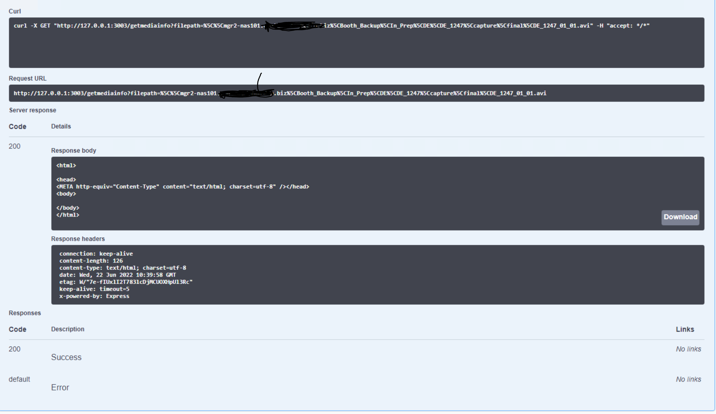

I have an issue with the webinterface which suddenly occurred and I cannot figure out why. I always get an error in the filebrowser when calling Mediainfo (ERROR getting mediainfo for ...). This only happens for files which are on our Network share and I am using UNC paths only. When I call files which are located on the Server FFastrans is running on I get the mediainfo response. I tried it with the:
FFAStrans 1.3.0.2
and webinterface 1.3.0.1
It is the same if I run it as service or start the server.exe. The service account has access to the share so should not be the issue.
Attached also some logs from server.exe. First call is from a local file and the last one is from the Networkshare which does get a response.
I tried the same via http://127.0.0.1:3003/docs#/default/get_mediainfo with the same result working for local files but not on the Networkshare.
Maybe you have some idea what would be causing this.
Thank you
David
