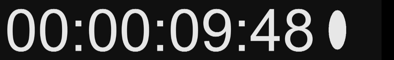

It is not really "adding a frame", it is just displaying the frame of the original main clip (02.mxf) at TC 00:00:05:00 (picture content = 00:00:10:01) because you specified the insertion point 5 seconds in your text file.
I guess it is a matter of perspective if it is correct or not, but anyway you have to live with it and it is easy to deal with the situation: Either just specify the inpoint in your text file as e.g. 4.96 instead of 5 (all in seconds), or use the populate vars node to calculate the i_insertion_point_frames and just subtract 1 from the final calculated value in the Populate vars node before the A/V media decoder.
Edit: i just read the documentation for avisynth trim function here http://avisynth.nl/index.php/Trim
Returns a clip starting at first_frame and running up to and including last_frame.
So it would i think the best would be to subtract -1 from the insertion_point_frames in the populate vars node (or in the .avs script itself).

I understand your point. It is not an extra frame it is effectively using trim just to get the exact correct amount. In this case. 4.96 is the exact correct amount. 5.0 is too much. using 4.96 in the text document has made a smooth transition for the insert point and has removed the pop in the audio.
1. point of insertion works perfectly if I put it is 4.96 and the audio does not pop... EXCELLENT!!!!. Thank you!!!
