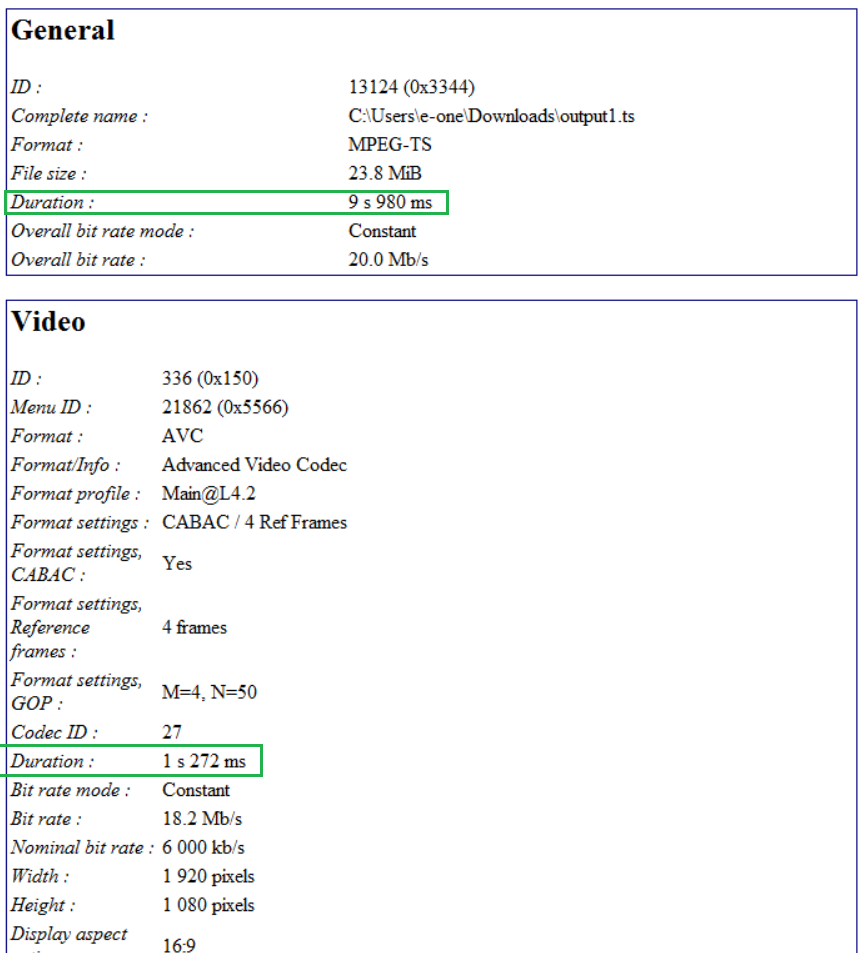

I've tested and the results are still not working in playout. The sample you provide is 1 second long? the duration of the video does not match the results of the general title (mpeg-ts) on mediainfo.

But could you tell us how you did measure 1s duration for @FranceBB's file? All my decoders/players say it is about 10 seconds.

I saw showing duration in the playout. then I checked through mediainfo and I saw the difference between the duration of the TS and the duration of the video. what reads on playout is the duration of the video.
Re: mp4 like Adobe premiere result
Uhm... I think I know what happened. I hope not, but I think I know... I'll come back on Monday with more tests and since we're at this I'll try to play with --bframes 3 --b-adapt 1 --no-weightb 1 in x264.
