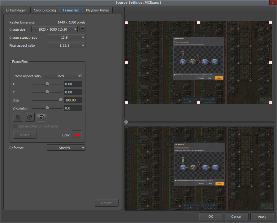

Thanks for the files. Avid Media Composer report 1440x1080 on the DNxHD file:
And comparing the original and the DNxHD file shows that the DNxHD has lower horizontal resolution than the original:
The upper is the DNxHD and the lower is the original.
So this is why FFAStrans, or rather ffmpeg, says 1440 because it is 1440 with aspect ratio of 1.333, which of course scales to 1920.
