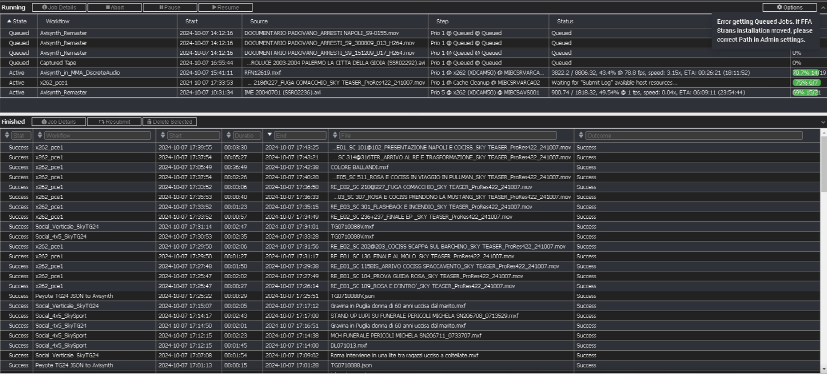

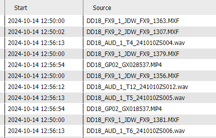

Been looking a bit further, and I've noticed some other things - just giving feedback, not complaining :P
The job overview also sorts kind of oddly. Active jobs are at the bottom, and the queue seems to get disorganised over time (older and more recent submitted jobs get jumbled). In previous versions, it seems like the view was sorted by state first -so they would be at the top -, and then start time, ascending - oldest queued jobs are right below the active ones, since they would start first after the current ones are finished.
-- though as I'm writing, that doesn't seem to happen right now? EDIT: Again, screenshot attached below.
Screenshot Queue.png (24.56 KiB) Viewed 89306 times
These are pretty much nitpicking though, this kind of thing is up to preference, I know :) Functionality stays the same.
Sometimes there's an error getting queued jobs ("Error getting queued jobs. If FFAStrans installation moved, please correct Path in Admin settings.)". I noticed however that the API (ip:3003/tickets) returns an error at that point, ENEONT no such file or directory. It complains about a .json file not existing in the FFAStrans folder. Im not sure if that is something unnique on my end though, seems to happen only when serveral jobs are processing. (I did change my network setup to improve responsiveness, as suggested by FranceBB and yourself. WebUI and FFAStrans processing are completely split, processing cache is separated too).

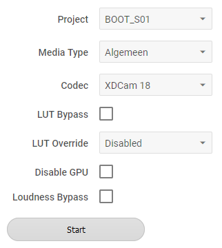

Variable editing in the UI works nicely in the fixed version. Being able to sort form fields and customise size is great! Makes for some neat forms.
Screenshot Forms.png (17.6 KiB) Viewed 89308 times

Stef wrote: Mon Oct 14, 2024 11:23 am Sometimes there's an error getting queued jobs ("Error getting queued jobs. If FFAStrans installation moved, please correct Path in Admin settings.)".
Yep, that's something I noticed as well and reported privately to emcodem a few days ago, but I'm really glad that you could reproduce it as well!
Screenshot from 2024-10-15 12-57-13.png (454.97 KiB) Viewed 89239 times
emcodem actually said that he's still working towards the migration from API to reading from file storage and that the issue we're seeing there is given by the APIs.
The very good news, however, is that we won't get that error for much longer.
To quote him:
The new approach cannot timeout, synchronisation happens in the background so timeouts can only occur on server side but not on client side.
I am seeking for the last fragments reading stuff from api right now
In other words, using the new approach, we won't ever see anything timing out as it will read from the storage, so unless getting files from the actual storage times out (unlikely and in that case you would have a much bigger problem than the web interface), it will never display an error.
As soon as the new file-based version is released, we won't face that error. :)

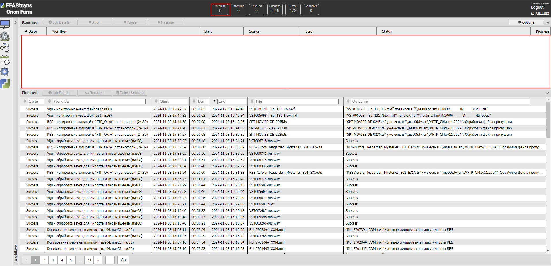

Hi guys, thanks for wonderful this project!

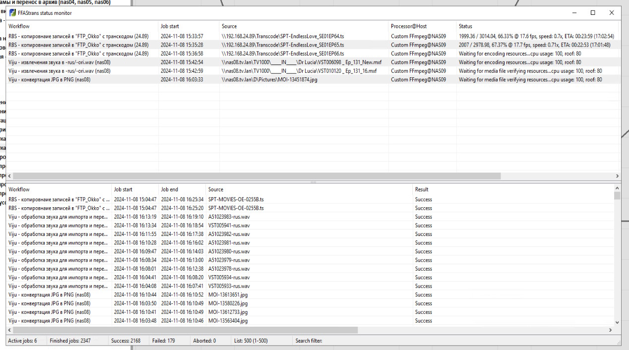

Noticed the following problem - current tasks are not displayed on the web page:
But in status monitor all is ok:
It wasn't always like this, originally it was okay. But after a while, it started.

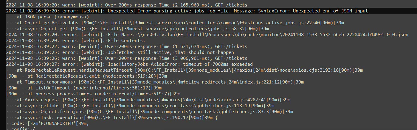

In log i see this errors:
It's fresh install of FFAStrans v1.4.0.7 & Webinterface v1.4.0.85. FF Install dir on SSD and webserver is on the same machine in same folder.
My logs:
logs.zip
(257.79 KiB) Downloaded 830 times
Can you tell what is the problem here?
UPD: oh and it seems finished jobs also stops updating on web

Hi @DCCentR
sorry for letting you run into this problem in first place and thanks for the report, perfect that you deliver the webint log along.
So my guess would be that you only see this behaviour when there are jobs running, taking away CPU and especially Bandwith to your NAS09 share.
It is of course important for me to support such problems but it is kind of hard to test, can you please confirm try raising the "API timeout" in webui->admin->Network settings from 7000 to e.g 120000? Meanwhile i'll reactivate some old Raspberry Pi and configure it as WLAN NAS so i have something slow for testing this kind of Situation.
What exactly happens:
So webint reads lots of files from the job history folder (history jobs can currently block active jobs update). When there is network activity, the Latency to the share raises, e.g. if you have 2000 jobs in the ffastrans history and usually each one takes 0.1ms, the response usually takes 200ms, so far so godd but as soon as you have network activity on the same netwok cable, the time for each file raises and we soon have 10ms per file or more, leading to a very long update time.
Of course i have already multiple strategies to try to cache stuff and avoid this but looks like some of it is not working as expected.
