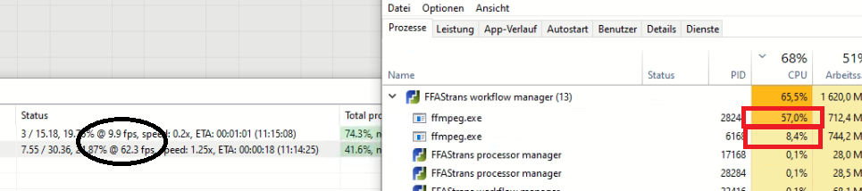

Re: FFAStrans hardware configuration
sorry for the delay, i first tried on my laptop but was not able to reproduce your results so i needed to wait until i get hold of a fast server to retry.
After all, i cannot reproduce your result that no filters is anyhow slower than filters. In fact, using a 30s source file, the "no filters" would finish encoding before the "filters" even started encoding at all.
Besides the starting time, "filters" for me runs significally slower than the other. In task manager i see exactly what i was talking about: some filter causes the stuff to run on a single core more or less:
I used a 720p50 source but i don't think the resolution of my source matters.
@mrazik, can you confirm your results and maybe upload a source file that you used for testing?
About CPU: buy what you can afford that has highest clock frequency and the most cores at the same time. Number of cores helps only for scaling multiple paralell encodings but not a single one. E.g. 8 Cores 5 Ghz would be (likely MUCH) faster than 64cores 2.2 Ghz for a single transcode. But the 8 Cores would be used 100% for one h264 transcode.
Up to about 16 cores can be more or less utilized ~100% with a single Fullhd h264 encode, depending a lot on it's settings of course.
If you have the choice 16 cores á 3.8Ghz vs 32 cores á 3.5Ghz i'd probably go for the 32 cores because you loose only 10% speed on a single encode but you can do 2 paralell.
If you can go highest level, it is better to buy 24 cores à 4.20 GHz than 32 cores 3.5 Ghz, but it's a pretty tight calculation. Anyway, GHz rules!
Also AMD threadrippers really perform well but are not common in servers. Personally i am happy with the fastest 16core Xeon Gold series.
About Software bottleneck:
Only when you use A/V decoder, the "disk speed" can matter at all realy. The "indexing" step is usually superfluous, it is basically only for repairing special defects in files but the avisynth ffms2 plugin requires to index always. Also, depending on the source file, it can happen that A/V decoder decides to generate an uncompressed version of your source file in the cache directory which would of course slow down the overall process massively and uses your disk speed basically 100%, maybe 50% for a very fast M2.
You'd need to find a way to get rid of the A/V decoder. I believe in your case, you should just use the builtin encoder procs instead of a custom h264, they will automatically insert any needed deinterlace or fps conversion stuff (as well as color stuff, audio stuff etc) into the finally calculated ffmpeg command internally. Thats actually one thing where ffastrans is pretty good in, to smartly calculate the needed ffmpeg cmd.
Using ffmpeg only without avisynth should usually get you rid of the single core filtering...
