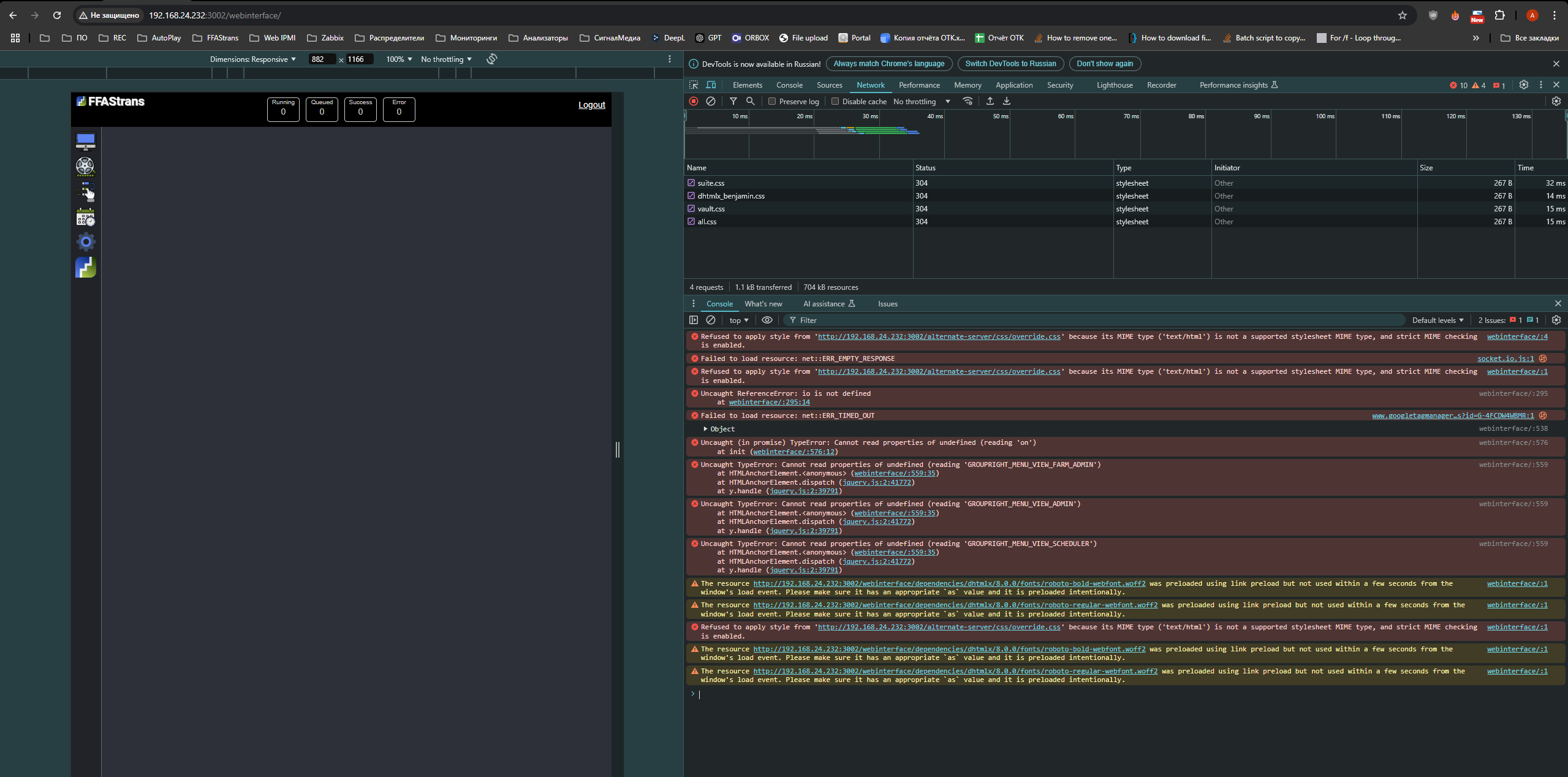

Hi, emcodem :)
I tried build 1.0.4.108. I installed the web interface from scratch in a separate subfolder inside the FF folder. After startup the interface is empty - nothing is loaded, admin buttons are not pressed:
Снимок экрана 2024-12-09 220430.png (232.47 KiB) Viewed 202893 times
Here is webui logs & db files:
logs.zip
(33.44 KiB) Downloaded 1785 times
database.zip
(394.83 KiB) Downloaded 1386 times

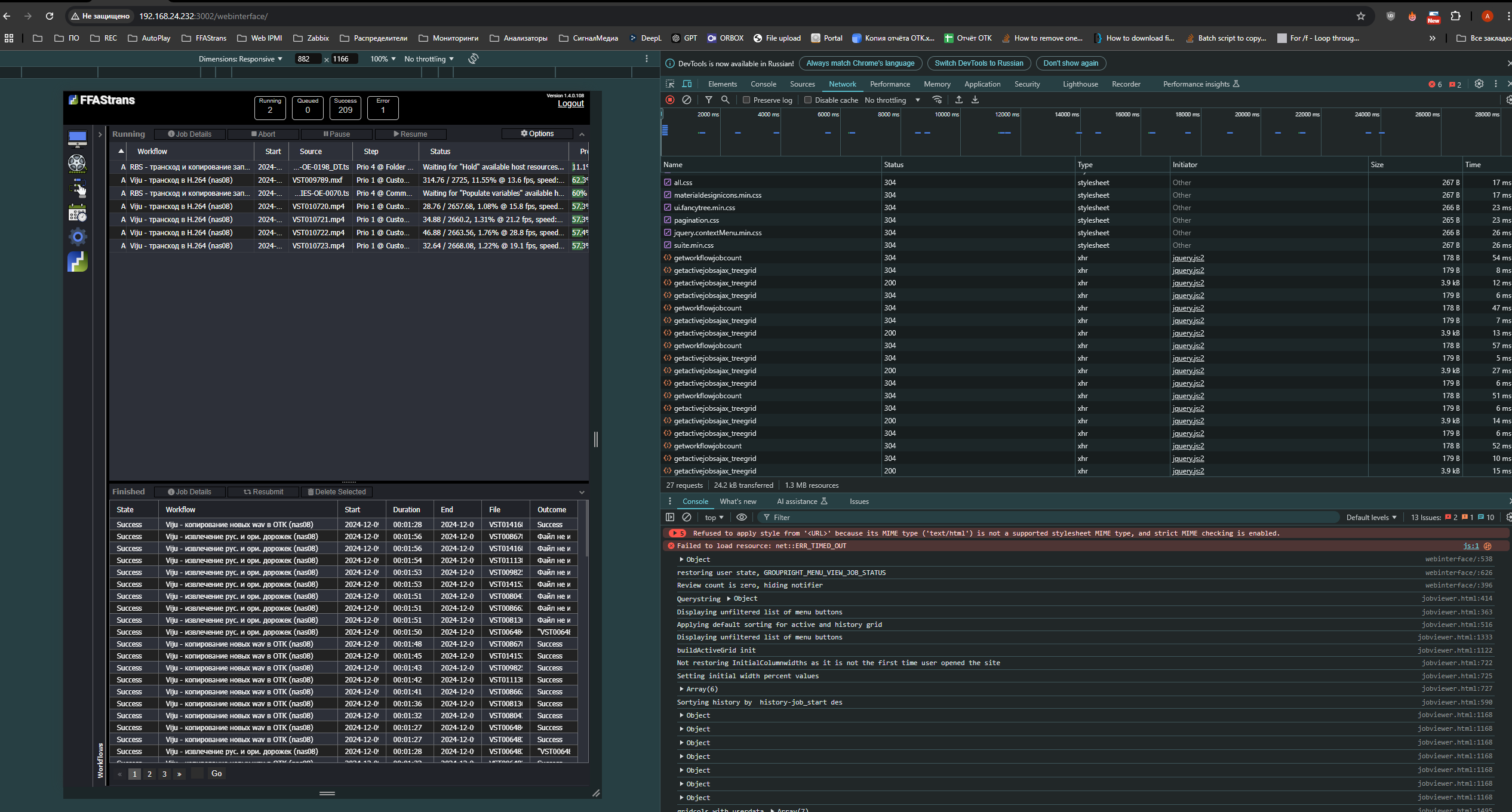

I tried reverting the node_modules folder from previous builds and the web interface seems to work as it should:
Снимок экрана 2024-12-09 221235.png (360.01 KiB) Viewed 202893 times
FF instal dir: \\192.168.100.231\FF_Install
WebUI: \\192.168.100.231\FF_Install\Webinterface
Did I mess up when reinstalling webui? :? 1.4.0.107 worked fine and I deleted node_modules when upgrading to it
Hey @DCCentR
thanks a lot for the try, really appreciate it!
yeah unfortunately me and benjamin noticed the same, tried it at work on a fresh server. It is a packaging issue from my side but i have no clue what exactly is happening, this socket.io dependency is really special to package. After i noticed, i even updated the prerelease you downloaded and added the node_modules folder so nobody could experience the same issue but obviously too late, sorry for that.
It will be better when i finish the complete page, too much has gone wrong with this feature preview.
If you have any special ideas in regards to jobviewer grids or page in general, let me know.
