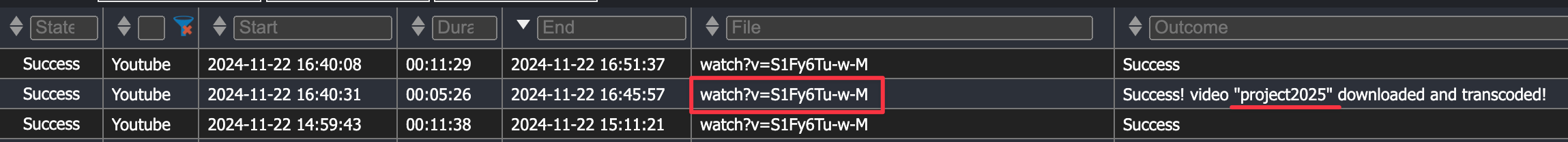

I saw a thread about a "pretty_name", and in the logs you can find that it has two options - a link-part and a file name from YouTube.
And here I have a question, whether it is possible to display the name in the "File" field, which I pass through a variable at the beginning of the job?
I already tried to did it - but it didn't work for me, is it possible at this stage?
Posted: Sun Dec 01, 2024 8:09 pm
@artjuice
that should be part of the next ffastrans version, i think steinar already has built in the option. It requires to set the value you want to display there from within the workflow (it is a special variable you can set with populate vars proc).
One other way to come around (besides using the outcome column) is to use a brand new feature of webint: variable columns.
Check out the latest pre-release for it:
https://github.com/emcodem/ffastrans_webui/releases
(Sidenote: one of us is going productive soon with this version i guess we will have a release pretty soon).
How it works is that on webint admin settings, "Job Viewer Columns", you can create a new column for the history jobs view and define some user_variable (or multiple) that are going to be displayed in the new column.
Of course it is not the same because the column is of course always there, regardless of which jobs you currently see on webint, so you'd need to update all workflows to populate something interesting into the new column.

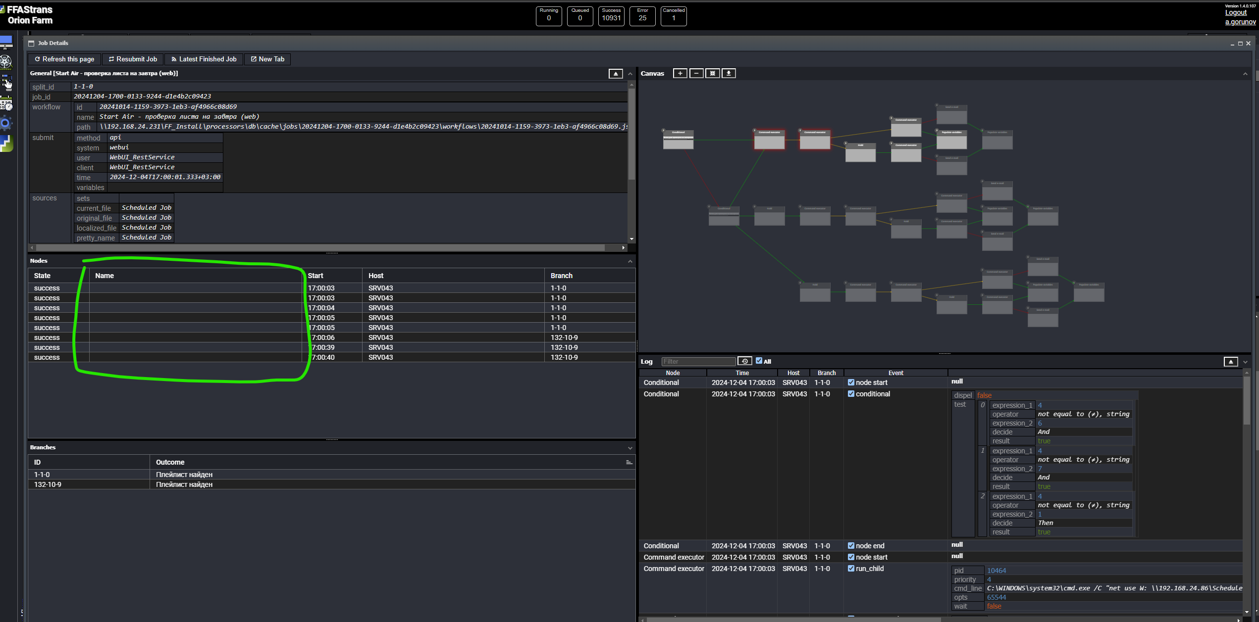

Looks like the names of Nodes are missing on Job Details window:
Снимок экрана 2024-12-04 172643.png (250.7 KiB) Viewed 203613 times
Posted: Wed Dec 04, 2024 8:47 pm
@DCCentR thanks, got it and can reproduce.. i fix that now. If you set the node name in the workflow, it would appear but the default name is empty.

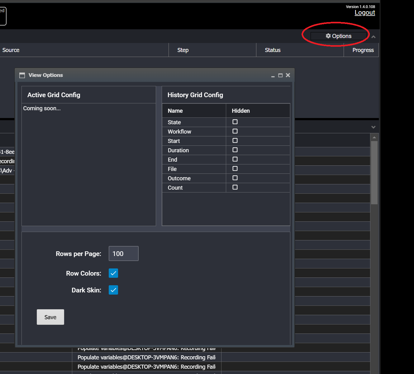

Next thing i am working on is rework the job viewer page, allow the user (and later admin) to reorder and hide columns displayed. The need for this goes hand in hand with the ability to create custom columns (variablecolumns).
It is something i wanted to do for a long time because the job viewer became old over time and hard to maintain. Mistakes were made regarding what underlying technologies i chose.
Version 1.0.4.108 is the same 107 but with a new history job grid and options window allows to hide and reorder grid cells.
If i was you, i would wait until the rework is finished and activejobs grid has been renewed too but of course i am always happy when someone tries my stuff early and finds bugs ;-)
Drag/Drop Columns in options win to reorder

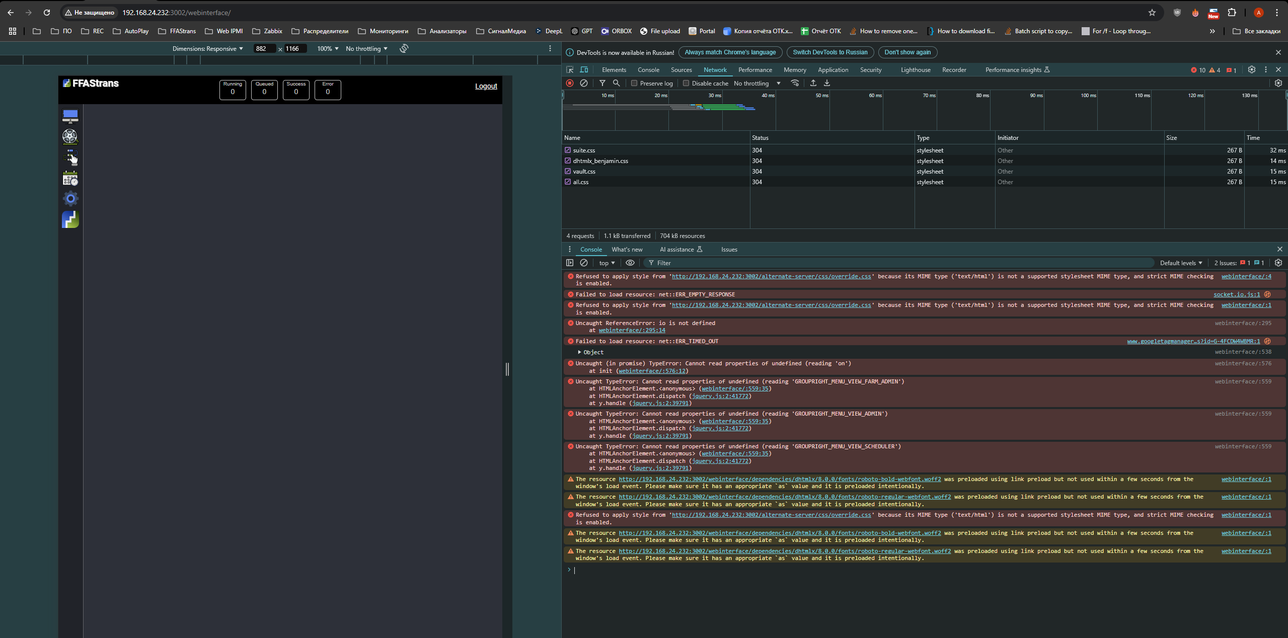

I tried build 1.0.4.108. I installed the web interface from scratch in a separate subfolder inside the FF folder. After startup the interface is empty - nothing is loaded, admin buttons are not pressed:
Снимок экрана 2024-12-09 220430.png (232.47 KiB) Viewed 203016 times
Here is webui logs & db files:
logs.zip
(33.44 KiB) Downloaded 1786 times
database.zip
(394.83 KiB) Downloaded 1392 times

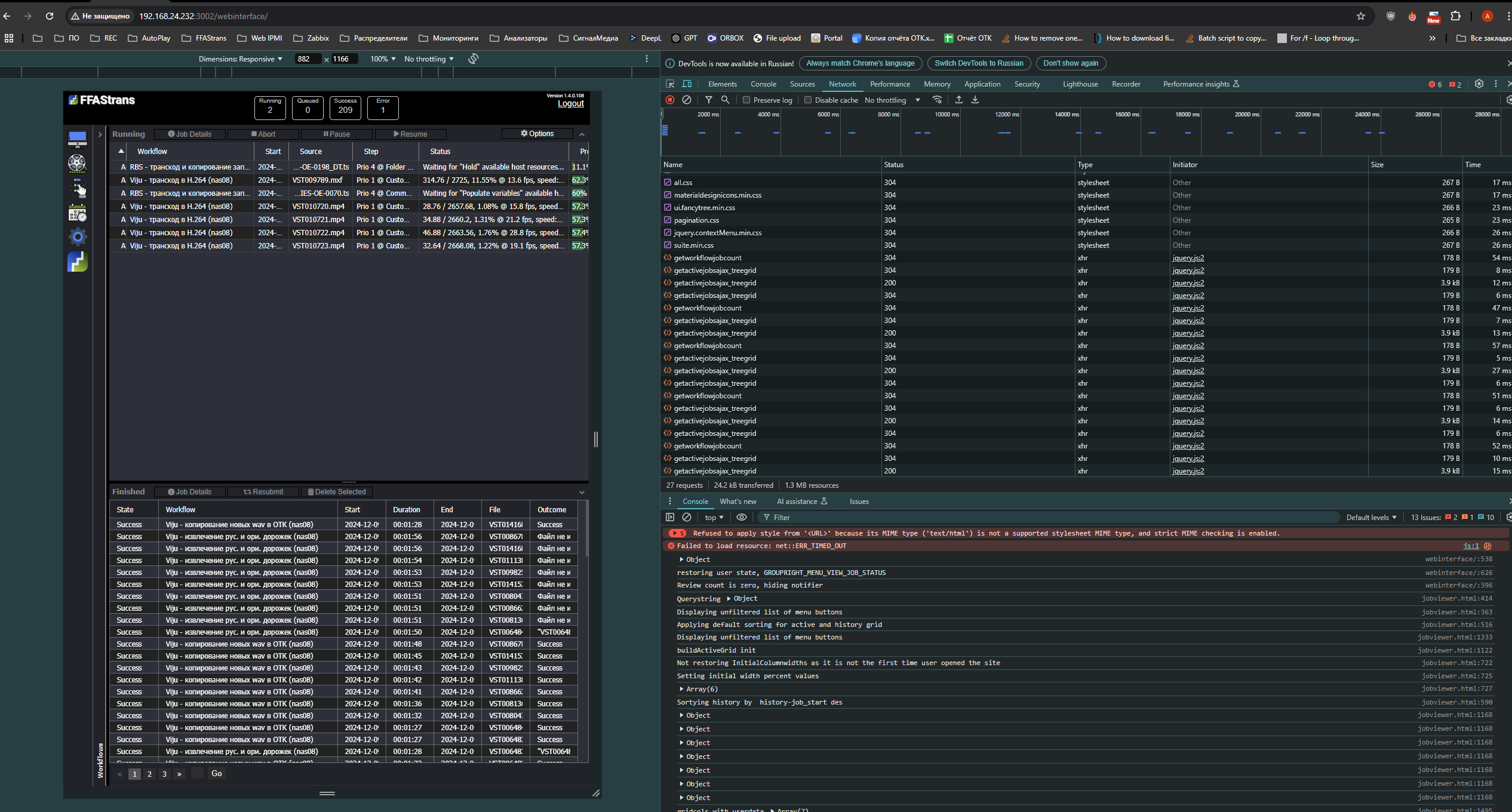

I tried reverting the node_modules folder from previous builds and the web interface seems to work as it should:
Снимок экрана 2024-12-09 221235.png (360.01 KiB) Viewed 203016 times

Did I mess up when reinstalling webui? :? 1.4.0.107 worked fine and I deleted node_modules when upgrading to it
Posted: Tue Dec 10, 2024 12:14 am
Hey @DCCentR
thanks a lot for the try, really appreciate it!
yeah unfortunately me and benjamin noticed the same, tried it at work on a fresh server. It is a packaging issue from my side but i have no clue what exactly is happening, this socket.io dependency is really special to package. After i noticed, i even updated the prerelease you downloaded and added the node_modules folder so nobody could experience the same issue but obviously too late, sorry for that.
It will be better when i finish the complete page, too much has gone wrong with this feature preview.
