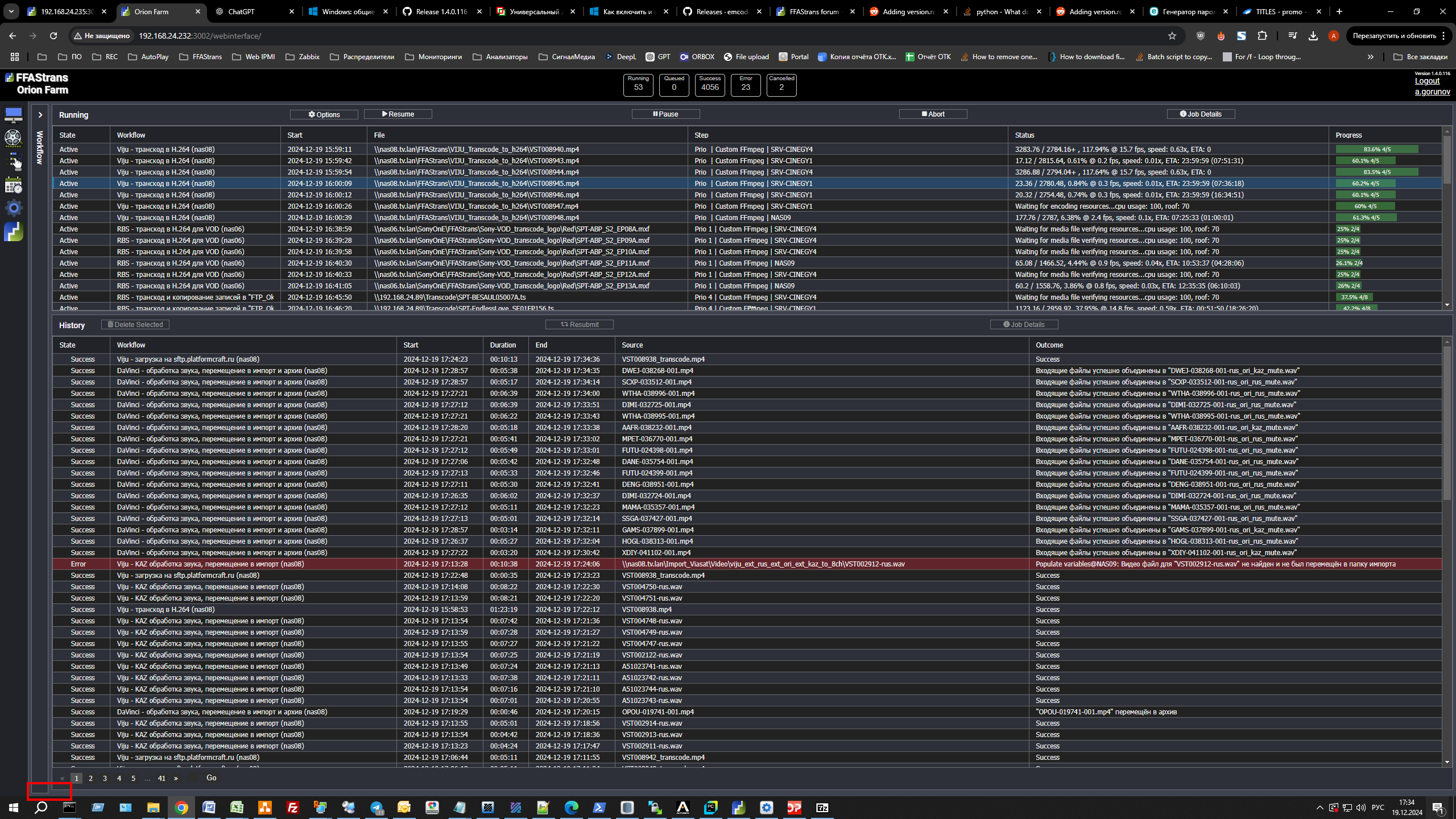

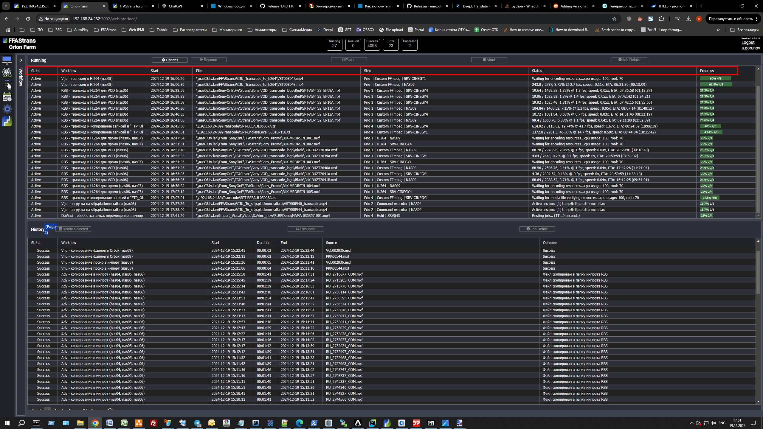

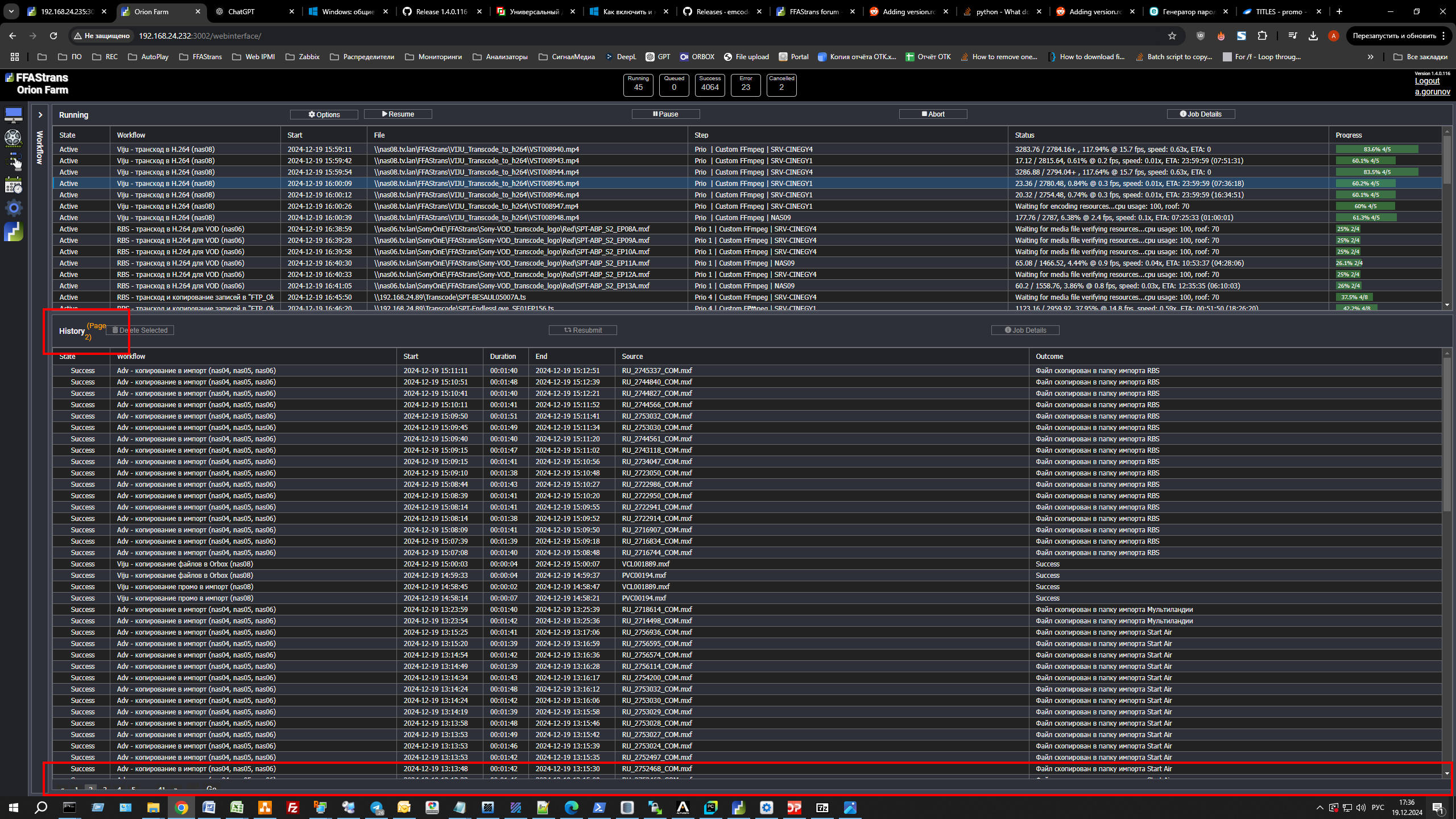

A small report on the issues noticed (likely most of it has to do with your currently ongoing rework, but still might be useful):
1) Looks like window of running jobs only updates upon manual page refresh in this build:
2) When switching to the second page and further in the history window, the page shifts down (apparently due to the “Page X” caption broken into two lines):

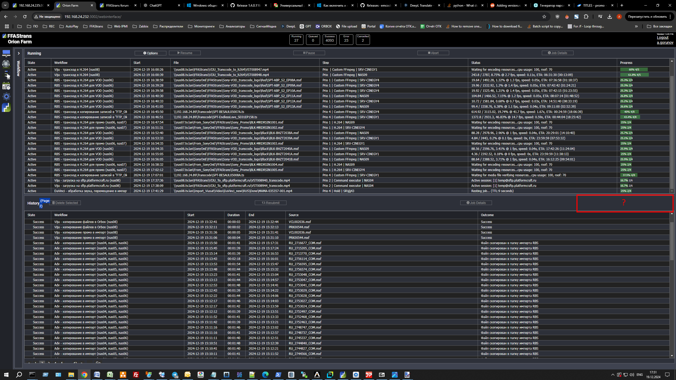

3) Layout resizer icon may be barely visible when the queue is full:
4) This area seems to have very narrow vertical frames, which causes the bottom of the letters in these headers to be cut off:
5) There is no longer a button to minimize the history window:

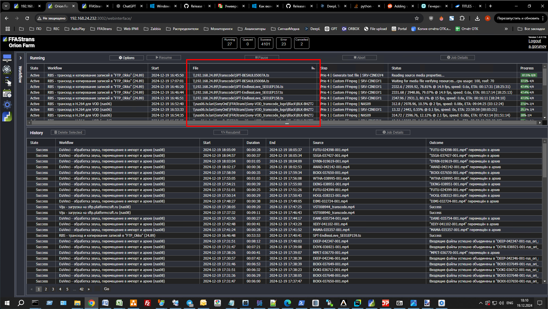

6) Is it possible to put the filename only back here instead of the full path (on 1080p monitors it can be a problem to fit all the columns needed)?
7) These windows are not aligned on the same line:
Posted: Thu Dec 19, 2024 11:17 pm
@DCCentR thanks, it is absolutely useful, i did not yet have all of the points on my list. Some of the points are already fixed, others not yet :D
Removing the path from filenames for running jobs was already done, then steinar complained that webint does not work exactly like the inbuilt status monitor so i reverted. I think it is more disturbing now because in the last version, we cut the right side of the path when the column was too small, i did not yet re-implement this feature at the reworked version. If thats not enough we might need to add a choice about how the stuff is represented.

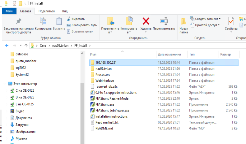

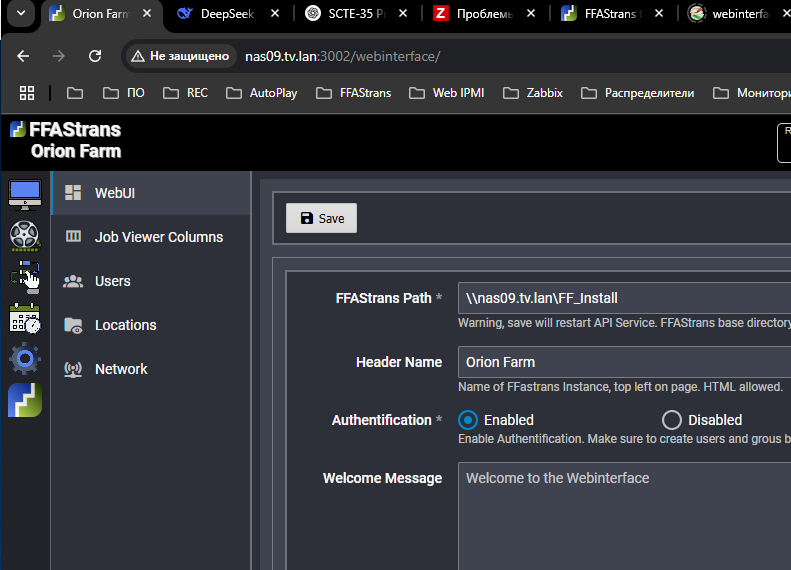

I'm trying to solve a small problem, server.exe keeps referring to a non-existent FFAstrans/WebUI installation path.
The FFAstrans/WebUI installation folder was moved from:
\\192.168.100.231\FF_Install\
\\192.168.100.231\FF_Install\Webinterface\
to:
\\nas09.tv.lan\FF_Install\
\\nas09.tv.lan\FF_Install\Webinterface\
Webinterface is currently running on nas09.tv.lan as service. Only one instance.
Снимок экрана 2025-02-18 110942.png (70.16 KiB) Viewed 202475 times

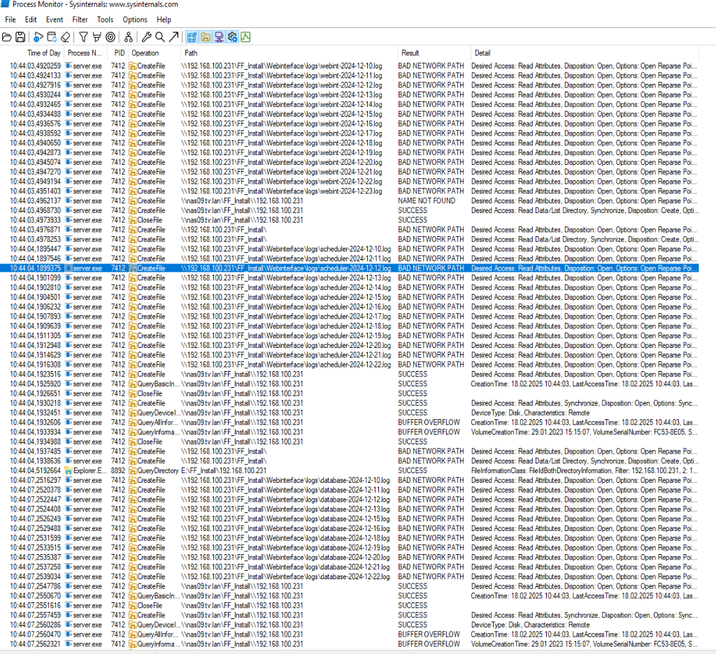

But for some reason Webinterface keeps creating the folder \\nas09.tv.lan\FF_Install\192.168.100.231 in the FF installation folder:
Снимок экрана 2025-02-18 110439.png (142.84 KiB) Viewed 202475 times
and tries to read logs from the path that is no longer valid - \\192.168.100.231\FF_Install\Webinterface\logs\

I was unable to find any mention of 192.168.100.231 in the settings/configs. What am I missing?
