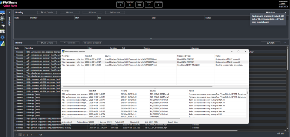

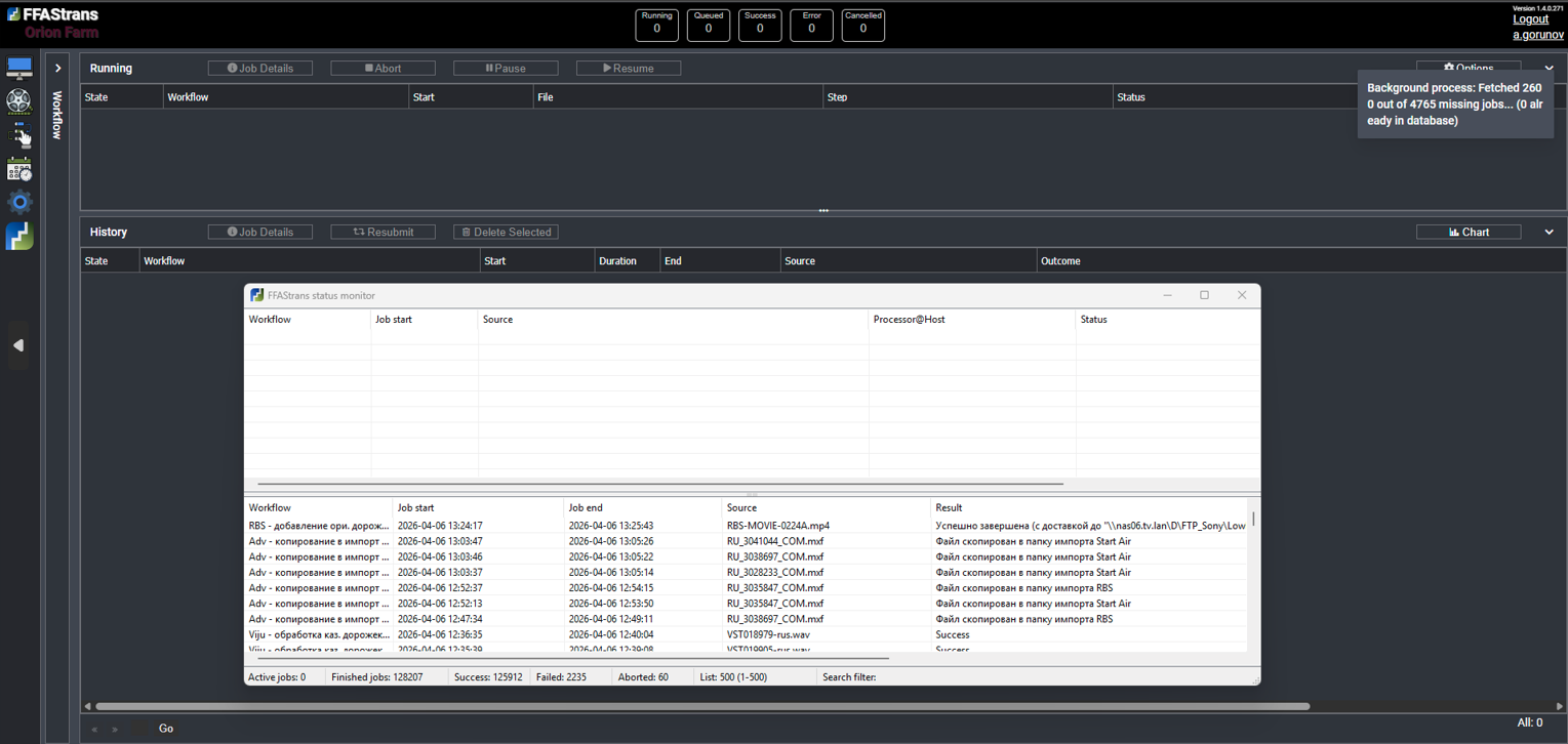

Hi, emcodem!
Thank for the update.
I tried to perform a clean installation (excluding the database\config file)
Here's how the new version works for me:
- A pop-up window appears in the upper-right corner saying “Background process: Fetched xxx out of 4765 missing jobs...”
Снимок экрана 2026-04-06 151925.png (234.75 KiB) Viewed 8240 times
Some time later:
- Once it reaches 4765 only a small portion of the jobs (290) appeared in “History”
- Then again a pop-up window appears in the upper-right corner saying “Background process: Fetched xxx out of 724 missing jobs...”
- Once it reaches 724 - still 290 appeared in “History”
- Running workflows are not displayed in the “Running” grid
Снимок экрана 2026-04-06 152124.png (234.21 KiB) Viewed 8240 times
Versions:
Снимок экрана 2026-04-06 131322.png (10.96 KiB) Viewed 8240 times
Logs:
logs.7z
(439.96 KiB) Downloaded 296 times

thanks a lot for giving it a shot! The issues did not appear for me because i only tested on my dev pc where its all on nvme, so even 100k jobs was too fast for the same issues to reveal. Not displaying running jobs seemed to happen only while the backlog import was slow. Now i tested on UNC and optimized the initial job import:
Updated Version:
https://github.com/emcodem/ffastrans_we ... 0.277-beta
Posted: Tue Apr 07, 2026 8:46 am
by DCCentR
emcodem wrote: Mon Apr 06, 2026 8:14 pm @DCCentR
Updated Version:
All my issues seems fixed in this one, thanks! ;)
