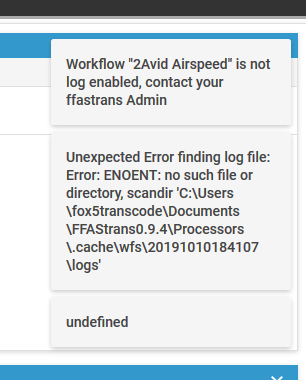

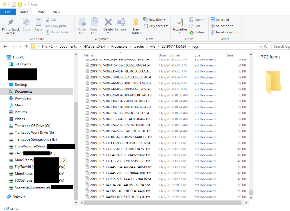

I'm having an issue with the web interface, saying that a workflow is not log enabled, even though it is set to log enabled, and I can see the logs in the correct folder its looking for.
I have another workflow that shows the logs correctly in the web interface.
I've tried restarting FFAStrans and the web interface, but the issue persists.
Any ideas?
EDIT:
I just noticed that its trying to pull the logs from an old workflow folder, even though the workflow is logging to the correct folder with its workflow id. Is there a reason why the web interface would be trying to pull the logs for this workflow from an old folder?

Hi @failsafe5000
thanks for using the webinterface :-)
Looking at the code section of interest, i can imagine this can happen if you have 2 workflows with the same "name".
If that is not the case, can you please check if the workflow id in "log to files" is the same than in the General Tab?

I do have one other workflow that is disabled that is just called "2Avid". As for the log to files setting, the workflow id does match what is in the general tab.

Posted: Sat Nov 09, 2019 7:56 am
Unfortunatly i don't get what's the problem. After importing the workflow, for me it looks in the correct directory for the logs.
You might want to know that with Version 1.0 in a few months, this problem i not of interest anymore as all around logging changed.
Anyway, if you want to go on and get this working, you could zip and upload your whole ffastrans directory to here
https://drive.google.com/drive/folders/ ... sp=sharing
If you cannot share all the stuff, you might want to test how it behaves when you change the log directory in the workflow setting "Special" Tab to e.g. c:\temp
