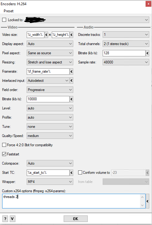

I was wondering if it is possible to write the command in the custom X264 option? Image located below.
Annotation 2020-05-29 153745.png (42.77 KiB) Viewed 26116 times

Haha good thinking, you are totally correct, the x26... encoders do not neccessarily need to use the ffmpeg -threads option because you can override ffmpeg settings using private codec settings as you point out.
Just the syntax is different, this is what you want:
threads=8
As the field says, it shall contain the "value for the ffmpeg option -x264-params, this is documented as follows:
ffmpeg -h encoder=libx264
-x264-params       <string>     E..V..... Override the x264 configuration using a :-separated list of key=value parameters
it looks like key=value:key=value:key=value
The possible key:value pairs can be seen at the x264 documentation, e.g. here:
http://x264.janhum.alfahosting.org/fullhelp.txt
Note again that all parameters that are listed in the x264 help are not provided with a preceeding "--" but just as key:value when used in the ffmpeg -x264-params field.
I did update the wiki accordingly, i guess currently only ffmpeg experts are able to use this field :-)

Okay first of all I did try this
threads=8
. However, I could see all the course fluctuating.
Sorry to sound like a complete dance, but do I have to put more than just
threads=8
in?
Would greatly appreciate an example I will be sending that to those being YouTube channels I hope

Hello, I did give it a go. However, it seems not to work, :?
I set it to 4 threds as you can see. I did also try 1 as well as 2 threds.
Any help would be grateley appriciated.

Re: Limit the number of cores/threads
Posted: Tue Jun 02, 2020 4:20 am
Hey,
no need to test other configurations than exactly this one:
Unfortunately i cannot reproduce your problem, on my dev laptop with 4 cores, setting threads=1 limits the encoding speed to 1,5 while threads=8 encodes with 5x speed.
Your screenshot shows that you do lots of different stuff while testing. Can you please try one single encoding isolated and compare the final encoding speed?
