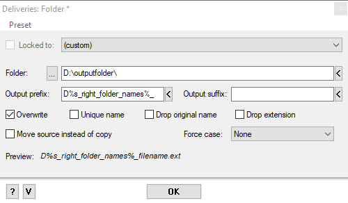

You will get the number in your folder name. Then, you can easily use this number at the end of your workflow inside the delivery node :
Feel free to tick "drop original name" if you only want the folder name instead of file name.
