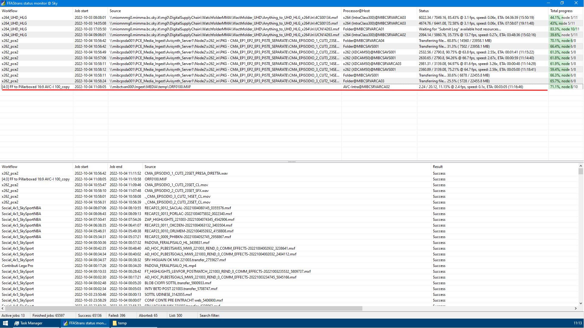

Ok, so, I've got your workflow and it's fine in the sense that it completed successfully on my end as I tested it on the same servers I use in production:
About the resizers, can you go to "C:\Program Files\FFastrans\processors\AVS_plugins\JPSDR\x64\" and replace it with this one https://we.tl/t-mDH93LuhBa and try again?
I compiled it with SSE (not even SSE2) so if it's an instruction set problem, it will work.
If it still doesn't work, would you mind installing the latest Microsoft C++ Redistributable from here: https://github.com/abbodi1406/vcredist/releases and test again?
Please test and let me know if it still doesn't work.
If it still doesn't work, would you mind trying this special build of FFAStrans I made? https://wetransfer.com/downloads/5929c3 ... 752/05563a
(for everyone else, please DO NOT use this build)
