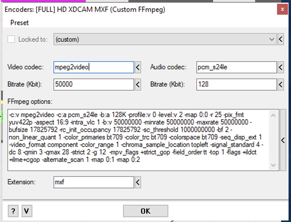

This is the custom ffmpeg settings:
This creates a file that has the second audio track with the incorrect codec (shows as pcm s16le and not pcm s24le in vlc), bitdepth and bitrate:

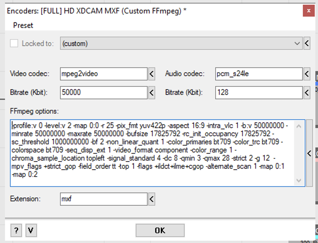

While if i manually duplicate the parameter in top part of the custom ffpmeg in the ffmpeg option section:
I get a file with the correct detaits:
