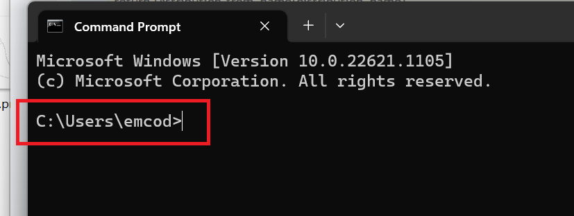

Also, you can try a cd command before executing the exe e.g. Prepend
cd c:\samepath &
In the commdline proc, where samepath is the currend directory you are in when executing it manually on cmd.
Just to be clear, this is the "cwd" (current working directory).
