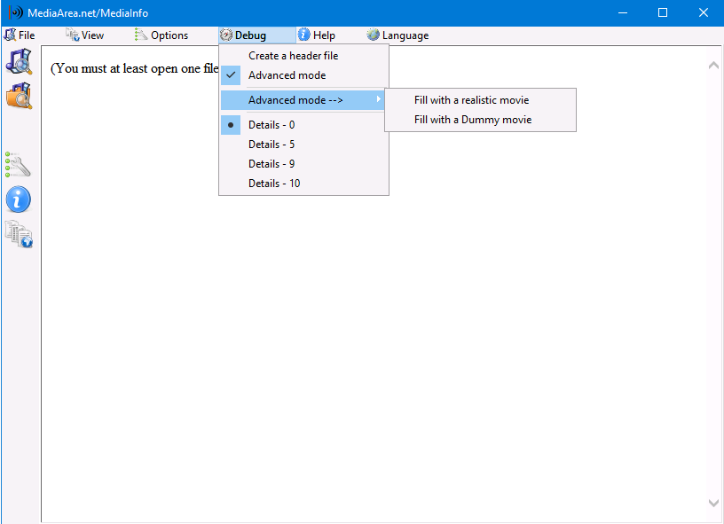

Pippo wrote: Mon Nov 06, 2023 8:43 pm Where can I find the advanced mode for sending?
If you're using the Mediainfo GUI, it's in "Debug" -> "Advanced Mode". :)
Screenshot from 2023-11-07 13-31-55.png (26.5 KiB) Viewed 12863 times
