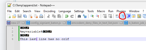

Last but not least, to check the full current content of a write text processor, you have to mark all using ctrl+a, insert it into notepad++ and hit the "show all characters" symbol middle top menu.
In this screenshot we see 3 linefeed and newline (CR LF) couples which i usually refer to as \r\n. Note that the last line does not have a newline which means if you append text and you want an empty line, you have to start your append with 2x newlines instead of only 1
