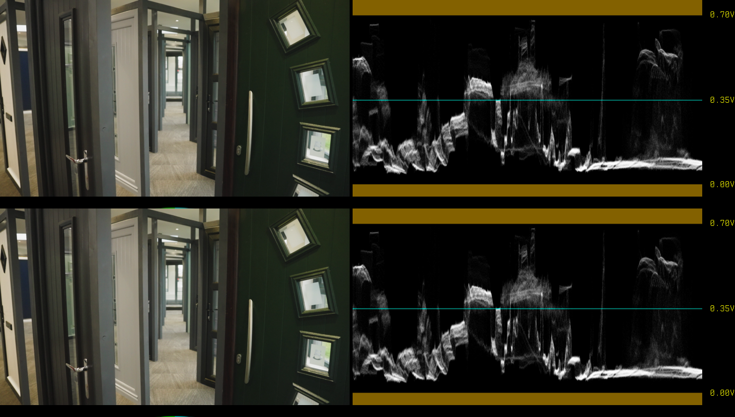

I downloaded both samples (the source and the encoded one), indexed them and then I used VideoTek() to see the waveform:
TEST MXF AVC INTRA 100.mxf000000.png (927.87 KiB) Viewed 130860 times
Top is the original AVC Intra Class 100 file with the normal limited tv range levels and the bottom is the output H.264 file with the wrongly compressed levels.
Emcodem already found the issue with the source, which is that it has contradicting information between the stream and the container where one says that it's limited tv range and the other says that it's full pc range, in fact Adobe Premiere exported a raw_video.h264 with the metadata saying "Full PC Range" and then it muxed it in an .mxf container saying "Limited TV Range". But... here's the thing: as long as you have the H.264 encoding node on "Set to Limited" the encoder won't touch the levels, but rather it will just leave them alone and just set the metadata, which is what is happening here.
If you look at the waveform from VideoTek() above on the encoded file, you can actually see that not only it's been compressed twice despite being limited tv range already, but I'm like 90% sure that it has been converted inside Avisynth itself. The reason why I'm saying this is that there's only one function that I know for a fact introduces those "lines" (the horizontal stripes you can see in the waveform) and that function is Levels(). If this happened on the filter_builder level in FFMpeg, we wouldn't have had those "lines" (i.e horizontal stripes) but rather a different waveform. This is corroborated by the fact that by having the encoder set with "Set to Limited" it won't mess with the levels.

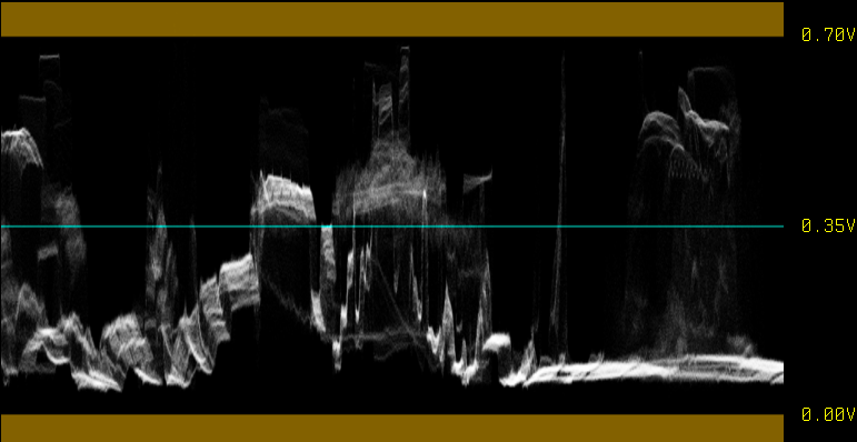

Frame properties after the Avisynth Script:
Screenshot from 2025-02-01 21-09-19.png (5.3 KiB) Viewed 130860 times
As you can see, it's set to Full PC Range (i.e _ColorRange == 0) instead of _ColorRange == 1, but it's "fine" 'cause the levels are untouched:
Screenshot from 2025-02-01 21-30-41.png (141.4 KiB) Viewed 130860 times

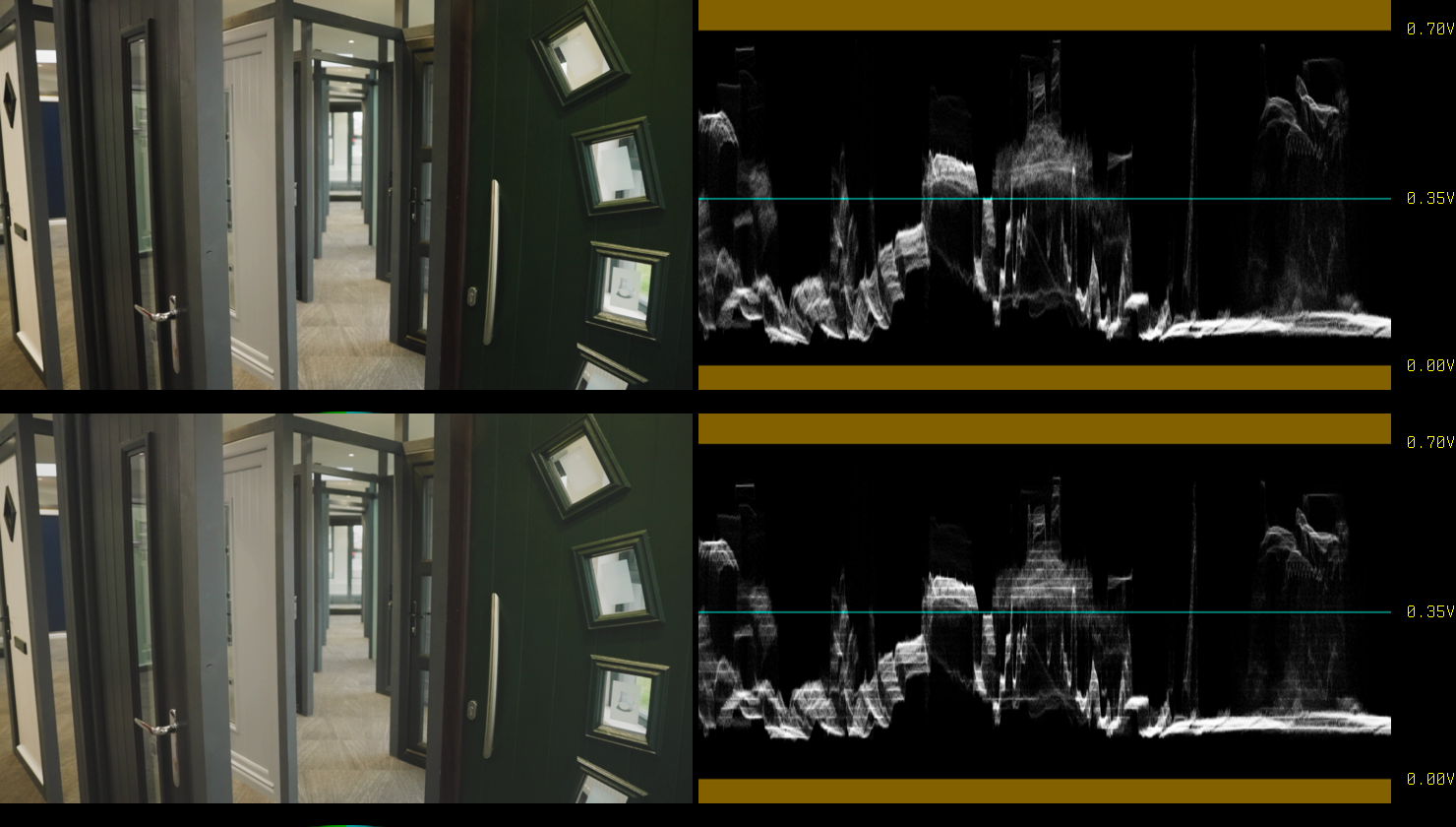

Here's the comparison of the input source alongside the output produced using your simple workflow:
TEST MXF AVC INTRA 100.mxf200000.png (944.17 KiB) Viewed 130860 times
Here's the outputted sample: https://we.tl/t-NKR9b6HTMl
Please note that all I said above is true as long as you have A/V Decoder -> H.264 Encoder, however it might not be true if you add additional nodes using Avisynth like A/V Decoder -> Filter X -> H.264 Encoder as the internal logic might be performing different adjustments according to the metadata, but yeah, it should work.
