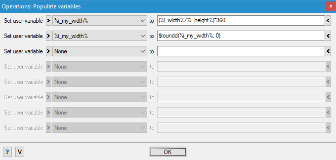

I'm sorry but you have encountered a bug. You reported it earlier and I was just about to give you an answer but then you removed the post. Anyway, the bug has been fixed for the next release. In the mean time you can try and use an undocumented feature which will be fully available and documented for the 0.8.0 release:
When you populate a variable you can use the function "$roundd(%i_your_variable%, 0)" to force your variable to an integer.
2016-08-29 (1).png (14.41 KiB) Viewed 25750 times
Note that this function is NOT official yet, nor fully tested and may change prior to the 0.8.0 release.
