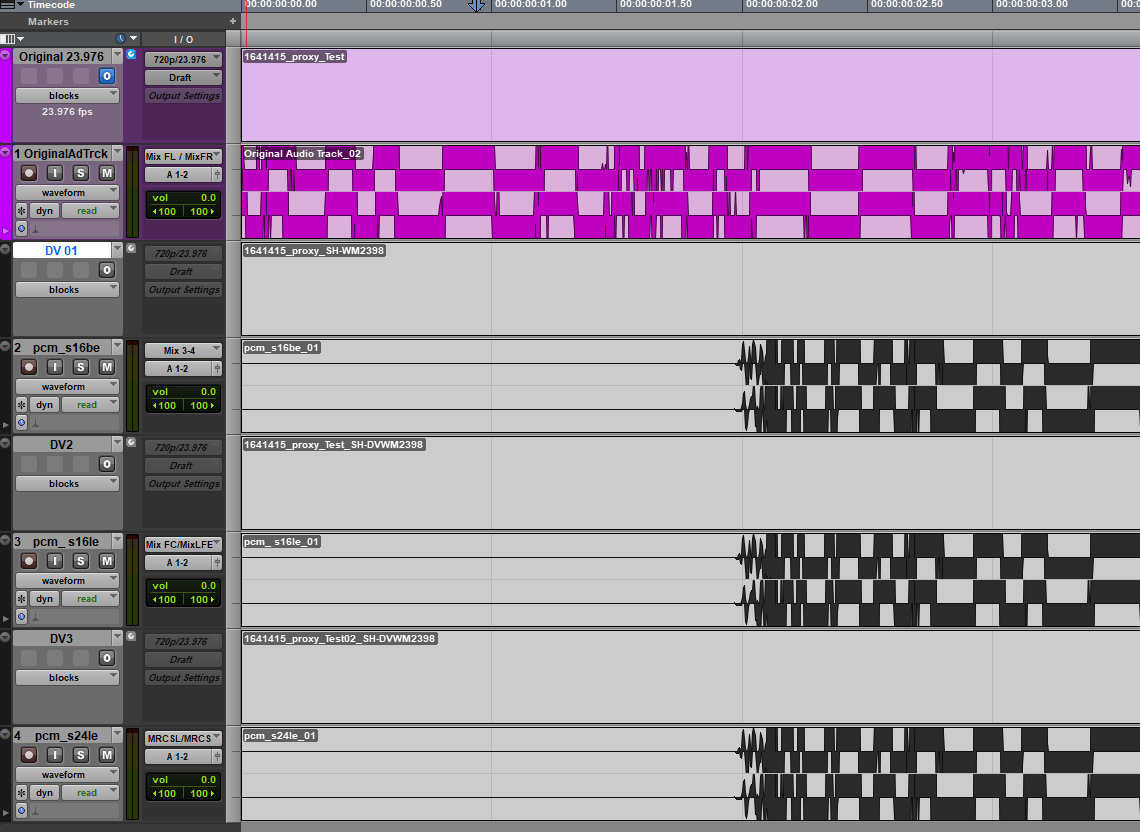

I'm already exporting uncompressed PCM. Can you guide me on how to add or remove 1 or more frames from an audio track?
My Custom ffmpeg encoder is:
-f mov -vcodec dvvideo -vtag dvcp -pix_fmt yuv420p -s 720x576 -b:v 25m -qscale 15 -acodec pcm_s16le -ac 2 -ar 48000
pcm_ s24le also gives the same result
check the attached image and let me know what you think.
Thanks.
