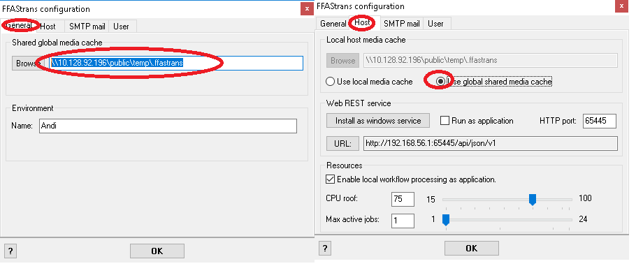

Personally, i prefer when all nodes use the same cache, so i have these settings:
For start, you don't need to install as a windows service, just starting the application from central NAS on all involved servers should work fine.

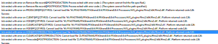

I've noticed I can process one file at a time, if I try more I get the below error messages. AVS_Plugins and also having trouble removing the file at the end of the job.
Re: Farm Enviroment
Posted: Thu Feb 21, 2019 3:48 pm
I see a W:\ as source file, is this a network drive? In Farm environments you don't work with network drives but UNC paths instead.
Anyway, it should work if W:\ is available on both servers when you run as application. Is this the case?
Same for starting ffastrans from network drive ("Z:\"). Pleaes start ffastrans from UNC path (\\server\share\ffastrans) instead of network drive
