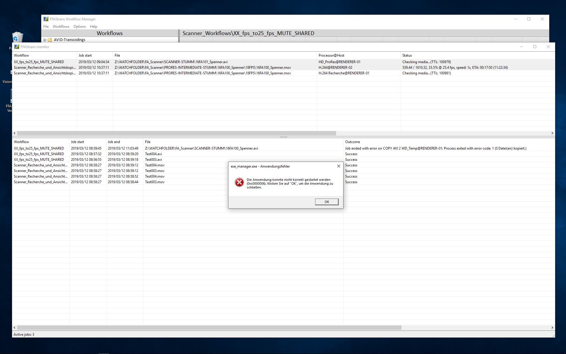

in the Working-Folder the file is growing.
I have now two files running, one 1159 seconds, the other 1381 seconds. Both AVI 2k 24Bit RGB. As described above, its all fine with smaller files (one second, same source, same size same bit-depth...).
Now the error occures on a CMD-executioner-node, which is only for copy ( %comspec% /c
"COPY "Z:\WATCHFOLDER\FA_Scanner\SCANNER-STUMM\RENAME\%s_original_name%_Archivdigitalisat.%s_original_ext%"
"Y:\WaitingDirectory\%s_original_name%\Temp"" ).
After this I get an error-message: Screenshot Number 1:
Screenshot (1).png (166.41 KiB) Viewed 13809 times

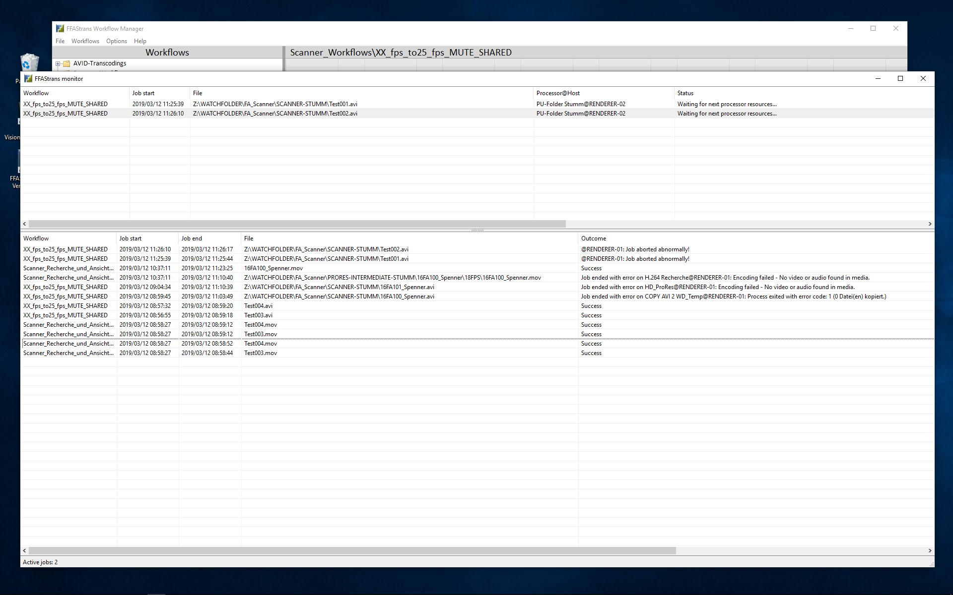

Then I try to render two files I already made in the morning. They both had no problems then. But by now, after the Error-Box, the Workflow seems to be broken:
Screenshot (2).png (169.71 KiB) Viewed 13809 times
As you can see in the FFAStrans-monitor, the first error on the Node (COPY AVI 2 WD) causes the rest of the encoding of the other file to exit on the Transcode-node. I was not aware of that, but in the end it is the same - I never had problems copying files that big to another NAS. The File-Size of 16FA100_Spenner is 267 GB. We have lots of those and already did many of them, but by now...
I will try Robocopy /Z /J instead of COPY. Will let you know what happens...
I attach the Workflow:
XX_fps_to25_fps_MUTE_SHARED_COPY.xml
(48.05 KiB) Downloaded 817 times
Re: Problem with large. AVI-files
Posted: Tue Mar 12, 2019 12:06 pm
Hey Thomas,
i see the error was with "exe_manager.exe" wich is part of ffastrans. I am not 100% sure but i believe you should restart not only ffastrans but the whole PC if you still have troubles (in order to make sure all ffastrans processes are re-spawned). This process should always run and is started with ffastrans. I guess if you now look into your task manager, you don't find any process named exe_manager.exe?
It is weird that exe_manager.exe is crashing because of just a copy command. Even the copy command itself should not crash. Typically such stuff only happens when some disturbing software is installed or you have a hardware error like defective RAM..

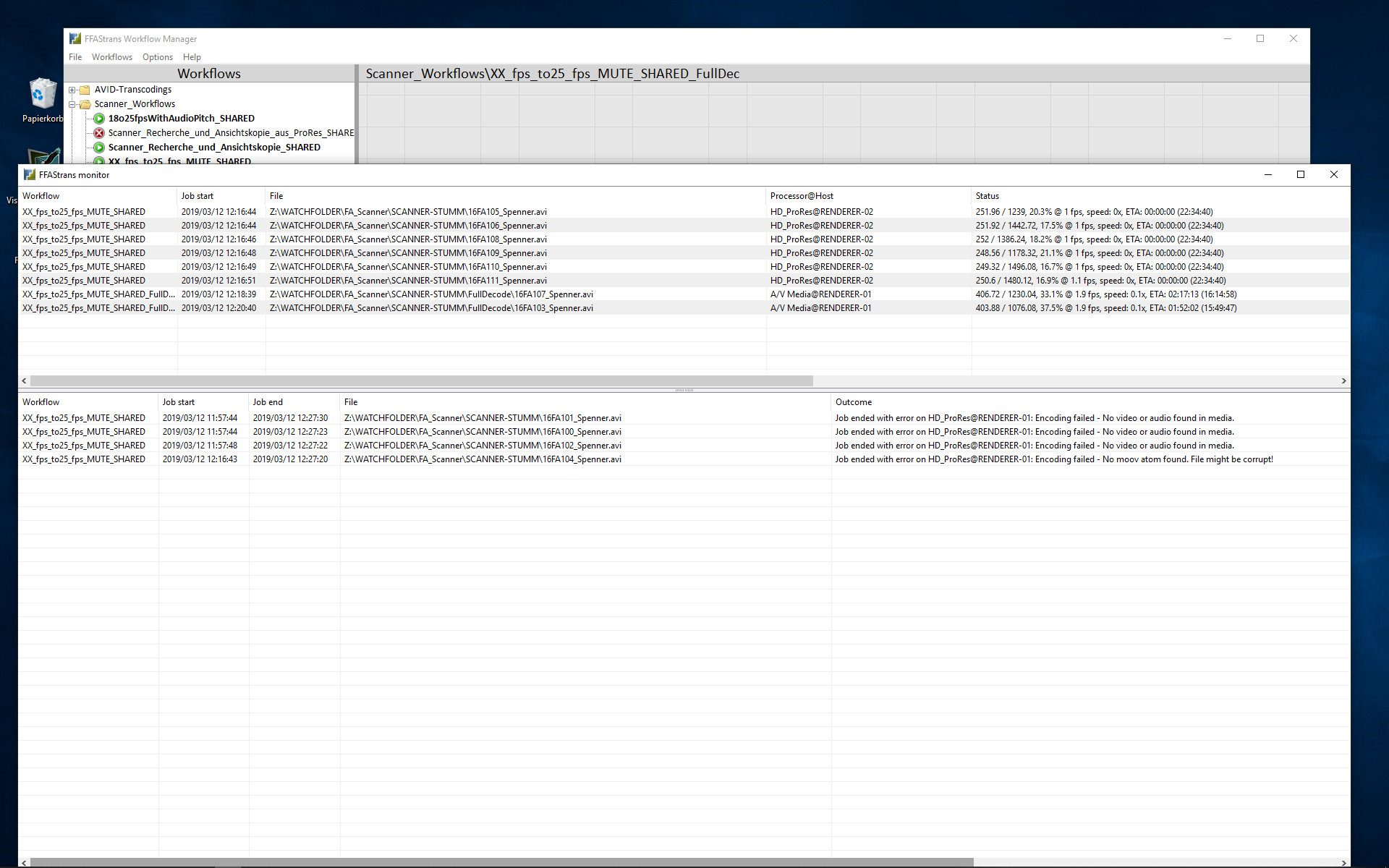

...and this is what I get from large files if it even does not make it up to the COPY-node:
Screenshot (3).png (179.11 KiB) Viewed 13801 times
tAke a close look: it is the same files that I tried to convert this morning. All four files started to convert and had a status comparable to the executed workflows in the monitor above. Strange thing.
What Windows-log is worth looking at? I never done this before...
