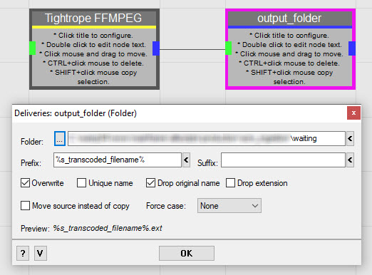

Guess this REALLY sounds like a newbie question, but I am submitting a new job with the API quite successfully, and including a uservariable to specify the name of the output filename I would like
$body = array(
	'wf_id' => $wf_id,
	'inputfile' => $input_file,
	's_myfilename' => $broadcast_filename
I submit the job, and it proceeds and completes as expected. However, I'm am completely missing the boat on how to USE the variable 's_myfilename' in FFasTrans. I can see a number of places to select them, but mine is not on the list anywhere. How do I get them there to begin with, so that I can select them in building the output filename in the FFmpeg output node?
The installation is almost vanilla. A single Workflow that the API submits to, with single output folder.
UPDATE
: I added the variables to an .ini file, and they're now visible.
I've since found a newer post that submitted the variables like this, but still no luck. All I can get is an output file named "%s_myfilename%.mp4"
"variables":[{"name":"s_myfilename","content":"myfilename"}]
12-12-2019 4-53-15 PM.jpg (75.61 KiB) Viewed 7921 times
Further Update
Having tried a "Populate Variables" node, it will work if values are added there, so it must be how I'm submitting them with the API.
I've now tried submitting them in all ways that I know, all at once, hoping one would be right - no luck, so I'm at a loss as to how to get them into the workflow.
Posted with http://localhost:65445/api/json/v1/jobs
array =
  wf_id: string = 20190326155521
  inputfile: string = C:\TVNI-S8E47.original.mp4
  s_transcoded_filename: string = TVNI-S8E47-20191212_broadcast
  variables: string = [
     {"name":"s_transcoded_filename","content":"TVNI-S8E47-20191212_broadcast"},
     {"name":"transcoded_filename","content":"TVNI-S8E47-20191212_broadcast"}
In all variations of tinkering, the final output is "TVNI-S8E47.original%s_transcoded_filename%.mp4"

Basically i recommend to check out the webinterface, you can submit jobs there with variables and check out the POST Body using your browser debug (F12) interface.
However, to make your life easy, i just submitted a job with variable through the webinterface and copied the post body for you:
POST to: http://localhost:3002/proxy/api/json/v1/jobs/
 {"wf_id":"20191213090328","start_proc":"other_textfile 20191213-090402-864-869eca762fe5","inputfile":"D:\\neu\\SL_01_Wien\\AVI\\Laursen_vs_Chapman.mov","variables":[{"name":"s_test","content":"test"}]}
You will notice that the variable name "s_test" is exactly the same than ffastrans would show when used in a processor but without the percent signs.
In this case, i created and and used a variable named %s_test% in my workflow. The workflow itself only had a Generate text file processor (really not more than that), which writes %s_test% to a file.
Also check in your specific case using error_log or similar, the exact string that your array function will end up in. You need to build a json object, not a json array. Also you have to put your variables into the first level child "variables", which is an array of all variable name->value pairs.

Firstly, thank you for the welcome. My previous question wound up using other methods as the number of variables was becoming too complicated with my limited understanding of FFAStrans at the time (more about that later). For this question however, it looks like I might have been json encoding part of the body twice before posting (extra escaping was there) :oops: . What the Web Interface produced for me was exactly what I thought I was doing, but a fresh start with the code produced it perfectly.
:idea: To clarify what I learned, and be sure I'm on the correct path, let me summarize:
  1. User Variables are introduced to FFAStrans by manually adding them to the [user_variables] section of ffastrans.ini
  2. To implement a User Variable in a workflow, one must first add a "Populate Nodes" to the workflow, then later disable/delete it
  3. User Variables must begin with s_ and are evaluated by wrapping them with % signs
