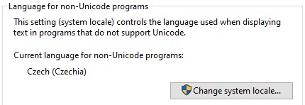

I'm afraid it can be (once again) related to the regional settings of Windows Server 2022
I have found the json files in mons\guid folder not in .\i subfolder.

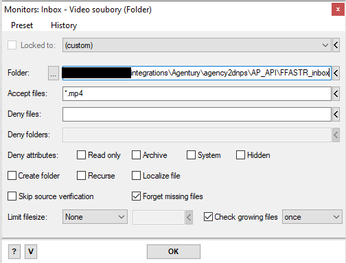

1) by dropping 0kb file with "long" filename 4636472_68c72bd169774e9a86cb0d697ba6cfd0_74c5be04b0504613928112ab531bc5ee.mp4 the result is identical ... file is ignored
2) as for monitor setting see the screenshot (I can PM to you the whole workflow if you want ... it is processing the MP4 files from AP agency) 3) it happens also when using \\localhost\c$\
I've got answers to few of your questions:
